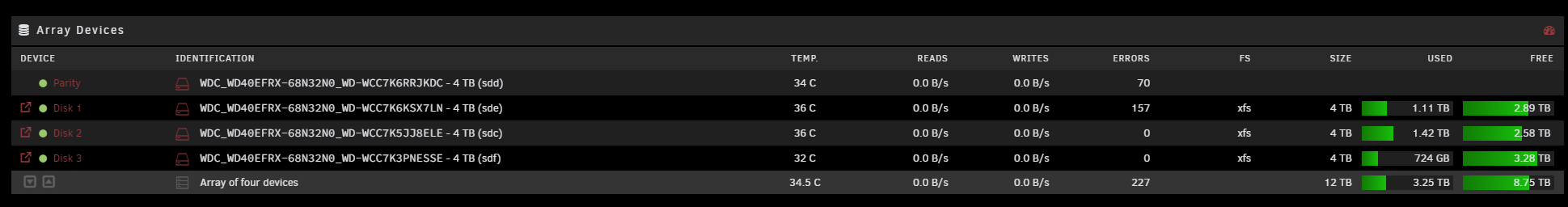

Parity and Disk 1 with read errors.
Hoping for some advice on my next steps. Il be honest, Disk 1 has had a few read errors for a while and probably best to replace it at this point. Wondering about the Parity though. I have done a non-correcting check and then a correcting check. Also ran an extended smart check on both returning no errors.

Both are logged as disk problems, I would try to replace disk1 first since that one looks worse, then if anymore read errors on parity replace it as well.

Unfortuantly I think this is a result of an unclean shutdown. If I replace disk 1 first, could I expect some lost files at this point?
