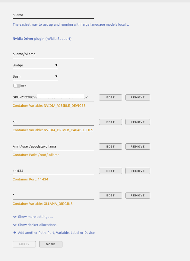

I am trying @Joly0 template and I can get it running using the Ollama-WebUI docker. I do NOT think it is using the NVIDIA GPU. I have a GT1050 and the NVIDIA drivers installed.

Hey guys, could you try going into advanced mode while editing the container, remove both variables for nvidia devices and replace the argument in "extra paramters" with this "--gpus=all"
That worked for me. If you guys get it to work aswell, i will update the template

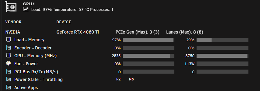

Atleast with these settings my gpu is used image.png.252ca0abdfa4cff3e6325dbc6146172f.png
Also when i created that template, the settings where working, so looks like ollama changed something

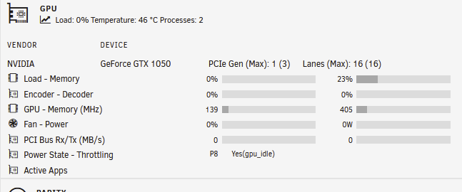

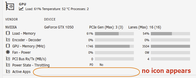

I think it's working but can't really tell the difference. I only have a 1050 GPU w/ low RAM. Here are the GPU stats being displayed before a question, and then while it is "thinking" . I would have thought everything would be pegged at maximum.
Before Asking a question:
While it is processing my question:
It is working.... and it is providing some nice answers.
