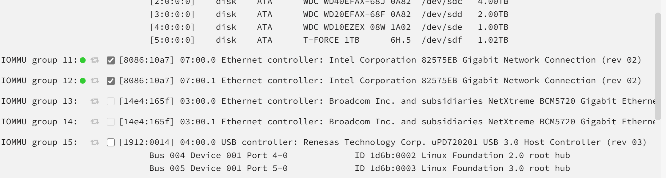

Is this the only device in iommu group? can you provide screen print of system devices for the nic?
I have PCIe ACS override set to both.
Have you tried both nics .0 and .1 to see if that works?
Yes. I think is has something to do with the motherboard. This is a HP Microserver Gen8. Before switching, I didn't have an issue with using the nic.
