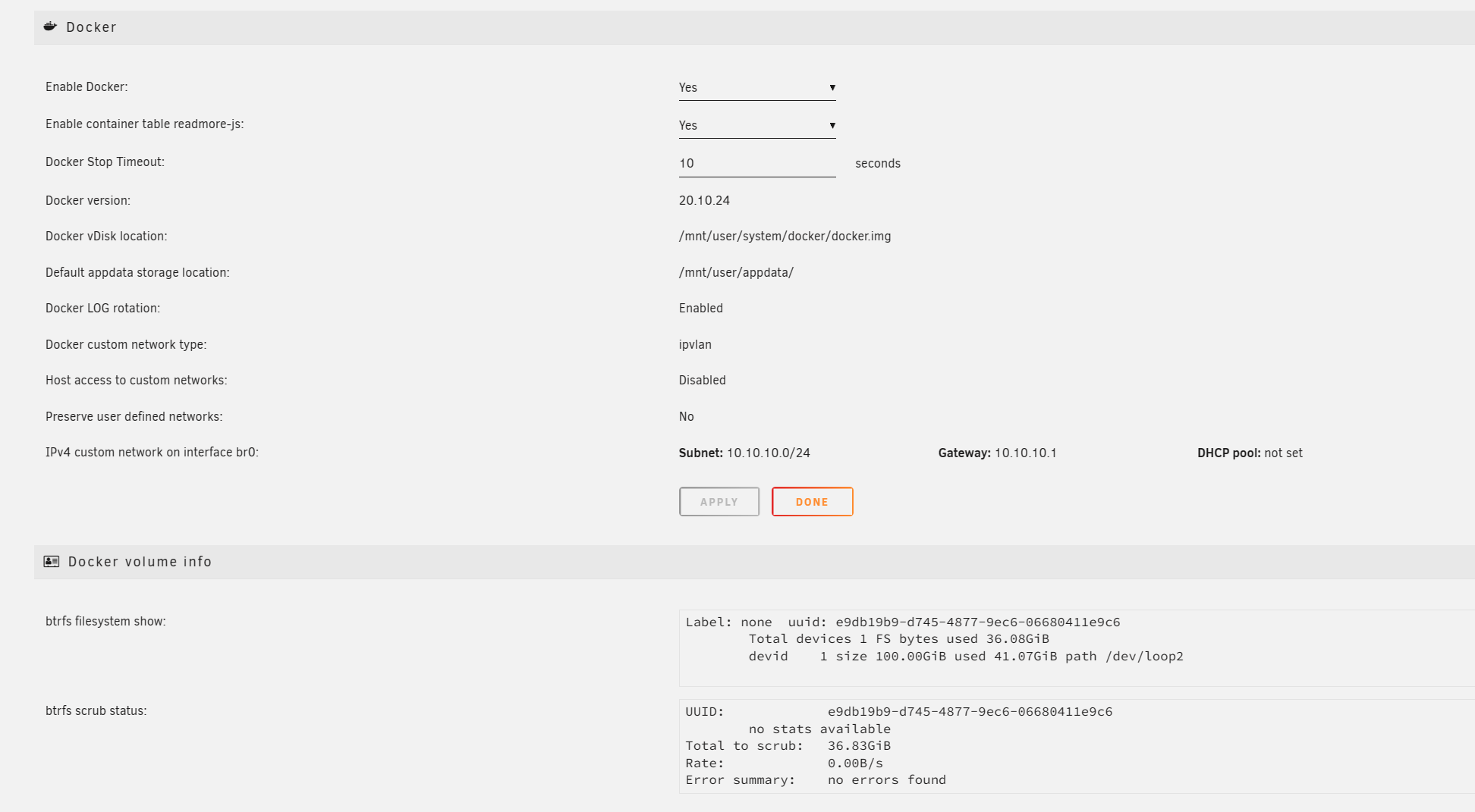

Macvlan call traces will usually end up crashing the server, switching to ipvlan should fix it (Settings -> Docker Settings -> Docker custom network type -> ipvlan (advanced view must be enabled, top right)), then reboot.
I Have Used Macvlan for a long time, I read that it can cause issues and when I rebuilt my dockers I set it to ipvlan.
for some reason It doesn't persist.
Maybe that is the issue?
It's still set to ipVlan.
so why does it keep trying MacVlan?
Did you reboot after changing to ipvlan?
Yes, Multiple times unfortunatelly.
this is the current syslog (with ipvlan, from the screenshot above)
still getting "x86/split lock detection: #AC: crashing the kernel on kernel split_locks and warning on user-space split_locks"
no macvlan messages in this log.

NETWORK ID     NAME      DRIVER    SCOPE
dd4cab41206e   br0       ipvlan    local
18215c076db7   bridge    bridge    local
57f7a15f2250   host      host      local
4ef795b60b3f   none      null      local
