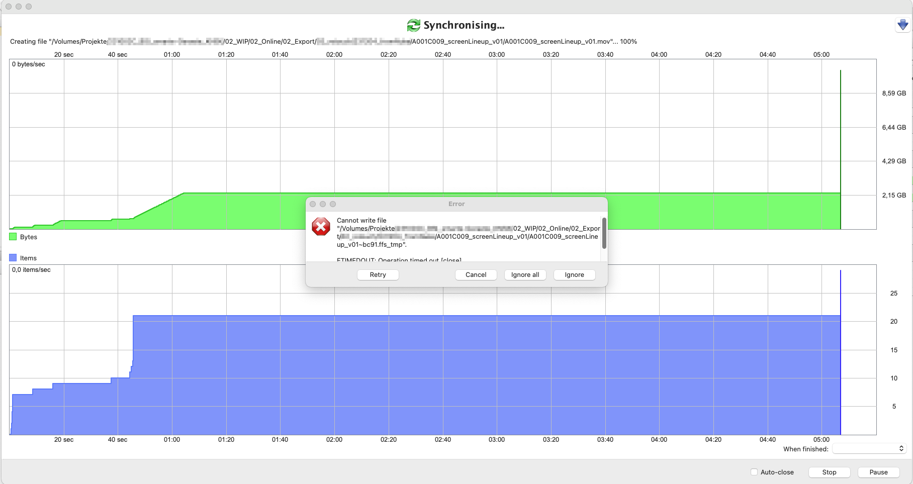

I run a project backup to the unRAID Server daily; there's a folder structure on my work-machine (macOS Monterey 12.6.7), and the same on the unRAID server. I usually use FreeFileSync, but the Finder shows the same behaviour. I can't copy contents of a folder, no matter from where I copy it.
I attached a screenshot from FreeFileSync. As you might be able to tell from the green graph, some files went through completely fine and when I reach that folder it starts to copy a file, around 99/100% it just holds, times out and gives that error. If I hit ignore the next file gets copied and the same happens again. I tried to copy that folder to my desktop and copy from there, no avail. I tried to copy by finder, nothing. I synced the entire folder structure to an external harddrive (the backup of that project) which worked fine, and then synced/copied from there, the same happens. I also tried to copy the contents somewhere else on unRAID to then move it with Krusader, but that also doesn't work.
I thought the data might be corrupt, but it's just a few Quicktime MOV which work fine (in QT as well as video editors), the entire folder is no 10GB large, unRAID has more than 7TB of available space.

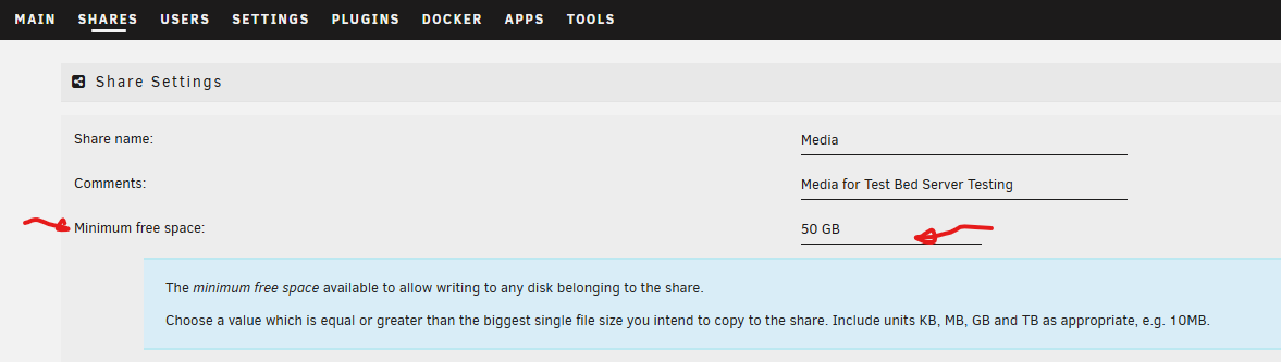

IT could be that there is not enough space on the disk that you are trying to copy the file to.  So, go to   Shares   and click on the blue Share name in the left column.  Than look for this parameter:
Make this parameter larger than the largest file, you will ever write to that share.  (I did a quick check on a couple of your shares and this parameter was not set on either one.)  Quick explanation, when Unraid starts to write a file to the disk, it has no idea how large the file actually is.  If the disk it elects for the write does not have enough free space for that file, the write will fail.  With this parameter set, Unraid will first check to disk to see that the disk has at least that amount of free space before it starts.  If it does not, it will check the next available disk in the array and repeats the check until it finds one with enough space.  It is import to realize that It is not the free space in the share that is important, it is the free space on the actual drive chosen for the write operation as the entire file must fit on that single disk!

In this case, we only steadily use the Projekte share, where this setting was already set to 80GB. As we work in a film production, it's hard to tell what the max size of a file will ever be, but 80 seems reasonable. The fullest Disk is Disk 1, which still has 1,36TB of available space - my files are less than 10GB combined, each file is around 1 to 2GB.
So I assume this can't be the issue, as it's setup and the individual disks all have enough space? (I wanted to balance out the disks a bit over night, but unBalance seems to just make one drive less and another one full, at least that's when I hit "plan", so I won't do that for now)
For a quick test, I set it to 100GB but also set the array as the primary storage, just in case the Cache acts up. But no avail either, it's the same as before - copy to 100%, halting, error, rinse and repeat. But only with those files.

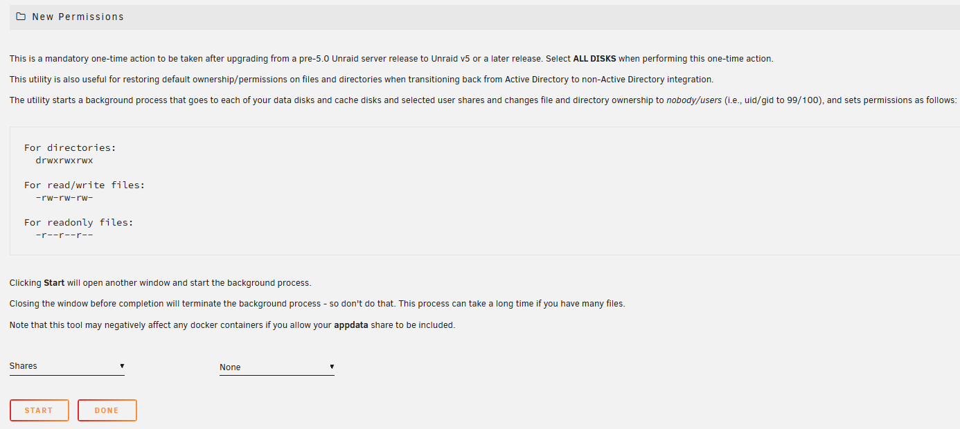

It might be that there is a  permissions on your Unraid sever.  Let's try this to try to fix them:.
1 -- Open up the   Tools    tab.
2--  Find the    New Permissions   tool and open it:
3-- Look at the screenshot below.  Select   Shares   from the left dropdown box and the Share with the issue ( Projekte ) from the right dropdown box.  Click  START.
It will take some time as it is Bash script and will set the owner/group names and the permissions on each file and directory in the entire share.

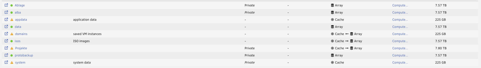

Looking at the Shares tab, all shares are either Private, Private in italics or have a dash (see screenshot)-
The unRAID runs here for close to two years, so I think if that public-login-issue was given, we'd have already ran into it?

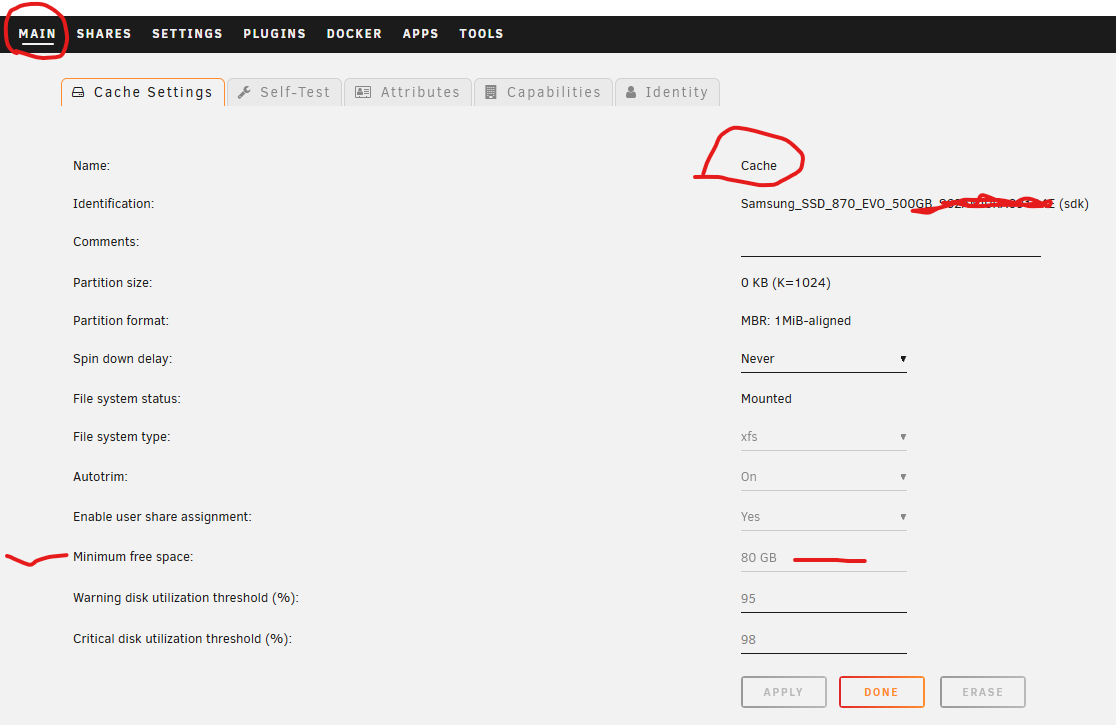

After reading this, I had an other look at your Diagnostics file and noticed that you only have a 250GB cache drive  and.  Since you are moving files of Projekte share through the cache drive, you should probably be concerned about the Minimum free space setting on the cache drive itself.  (I am not certain that Unraid honors the free space setting on the share when using the cache drive...)  You can set it here (after double-clicking on the 'cache' drive in MAIN):
You  do have to stop the array before you can change it. This may be a belt-and-suspenders type of setting but it worth checking out.  (Many folks have sized their cache  drives and set the Mover schedule so that this would never become an issue but with a 250GB drive, multiple users, and video files, you could be having an issue.)

Maybe I misunderstand the Cache and the Minimum free space entirely - the sync that stops working is around 300GB, but files are only around 10GB max in this scenario. Does this mean the Cache runs full (because it's set to 0GB I just saw)? I thought when this happens, it will just copy to the Array directly.
It's recommended to have at least as much "minimum free space" set to the max file size I expect - but to my understanding the minimum free wouldn't be touched, so it shouldn't matter if a 10GB or 50GB goes over that limit? I'm a bit challenged by this, haha
I just invoked the Mover, and will set the cache to 80GB as well; mostly we don't sync 300GB at once, mostly it's 10-30GB but then more often (like twice a day), with the Mover working every hour or so. If that doesn't work, I will try to bypass the cache completely. Maybe this is a different issue from the one I had earlier, after all :)

It will only revert to copying to the array if the free space is below the Minimum Free Space value BEFORE the next file is copied.   Having a value of 0 will effectively stop it ever reverting to the array.   That is why the it is recommended that the value is larger than the biggest single file you expect to copy.
I believe that in the current implementation the larger of the Minimum Free Space value set on a pool (cache) and the User Share is currently used.   I am hoping that these will be decoupled at some point as I have never understood why they are not applied independently depending on whether the next file is going to the pool (primary storage) or the array (secondary storage).
