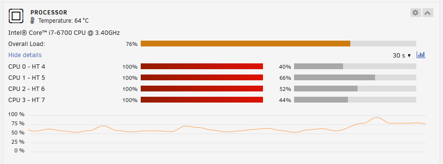

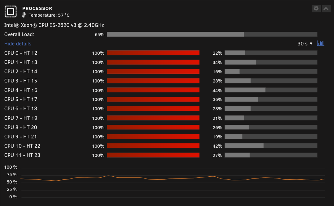

Recently, half of my server's cores are showing constant 100% CPU usage, and I don't know what is causing it. Does anyone have any advice? I think it started happening after I replaced my cache SSD, in case that is relevant.

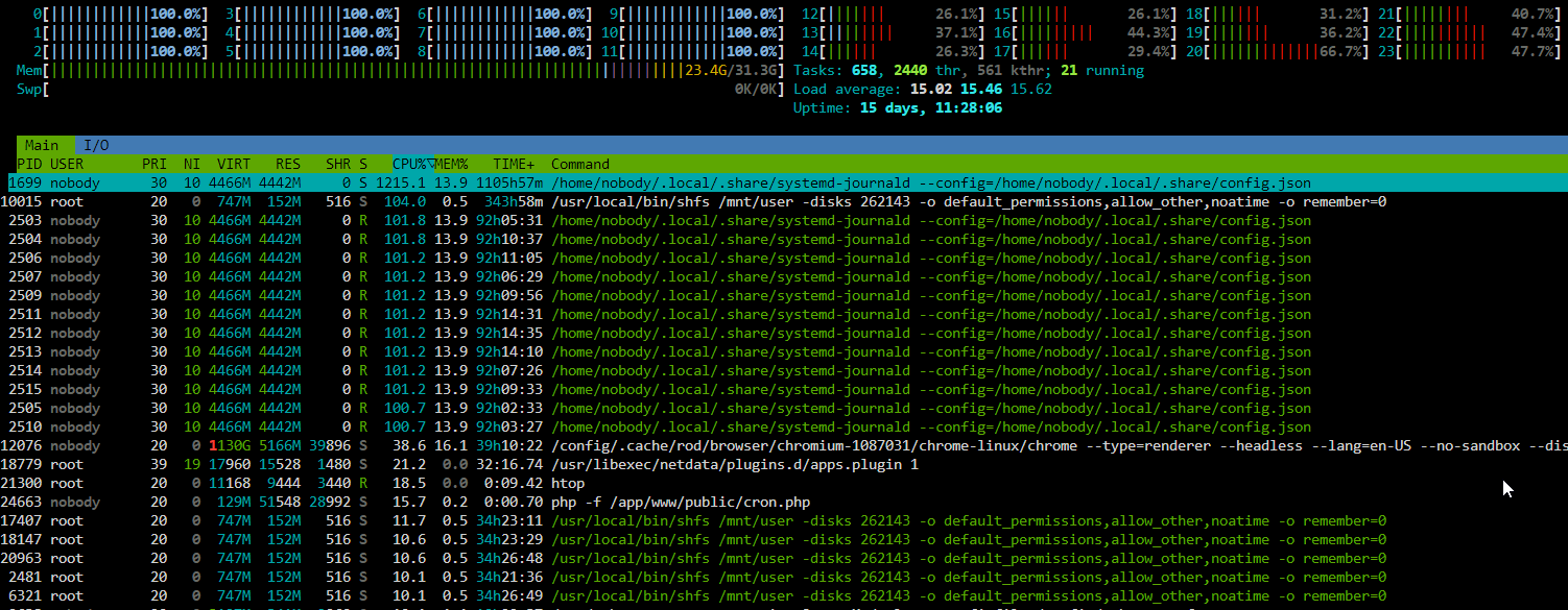

Open terminal and execute this command to see the running tasks :
htop
htop
Thank you for the tip. I am not sure what these config.json files are, but they seem to be the cause of the 100% usage on those cores.
Edit: I went through each docker container one by one and found that when I stopped qbittorrent (BINHEX - QBITTORRENTVPN), the CPU usage went back to normal. I'll have to keep an eye on that one I suppose.

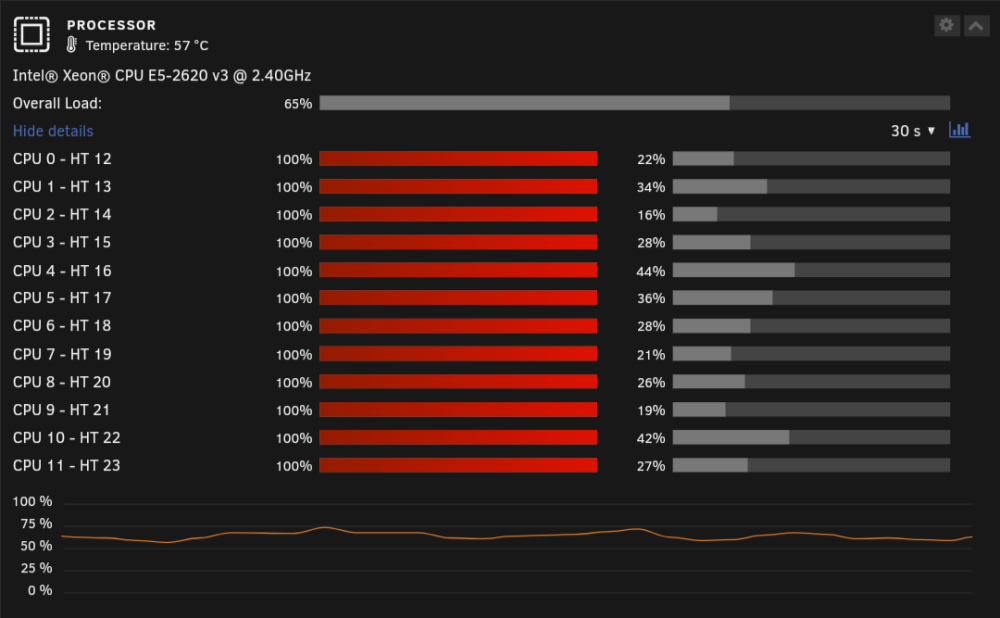

Hey, I noticed the exact same behavior with my Binhex QbittorrentVPN Docker. It’s very strange—it seems to be a process with no clear name that is already marked as deleted. When I kill it, it restarts the next day or so with a different name, also marked as deleted. It really looks like some kind of virus or malware. Have you found a solution for this?
What tells me that it is already deleted:
Edited by Ferecium
Not really, my solution was installing deluge instead of qbittorrent.
