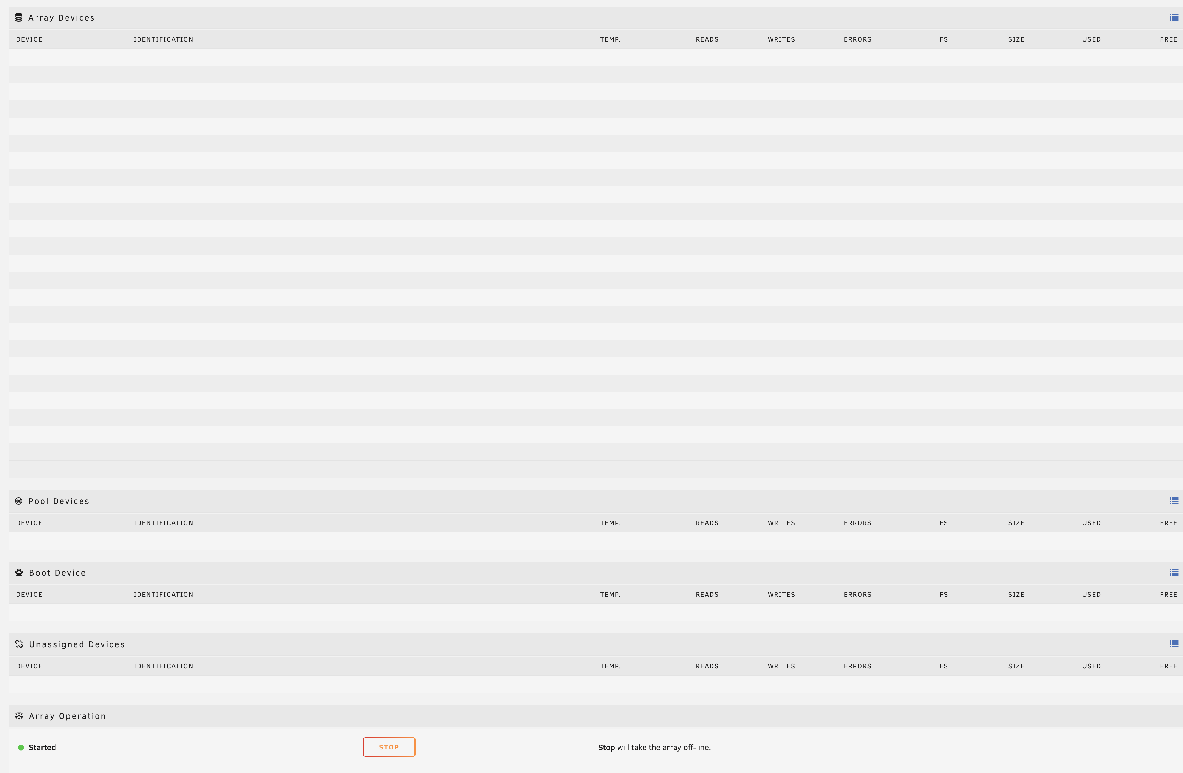

Doesn't look like a license issue anymore. It now enters a state where it doesn't answer any requests anymore.
This is the part of the log while it didn't answer requests anymore. I switched out the USB now to Kingston DTKN/32GB and brought over the license while blacklisting the old USB.
I only see some issues with SAMBA, but I'm not sure what to do about it. It looks similar to this issue:
But I don't have Bittorrent nor Plex running on this NAS. Only luckybackup, mariadb and phpmyadmin - all up-to-date.
The blank devices on main is a known issue that sometimes can happen, if you logout from the GUI and wait at least 30 seconds, then log back in it may help, but that's unrelated to hanging or the call traces, also unrelated to safe mode.
