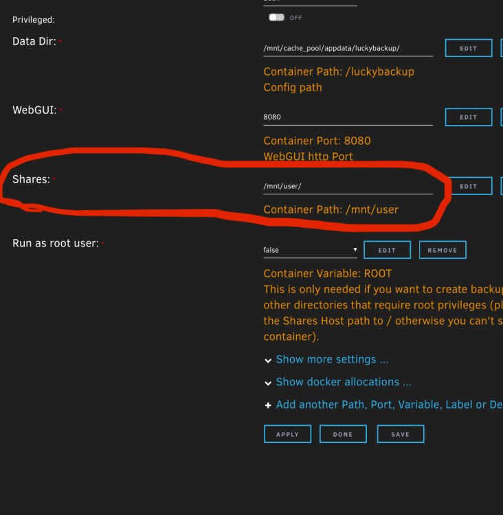

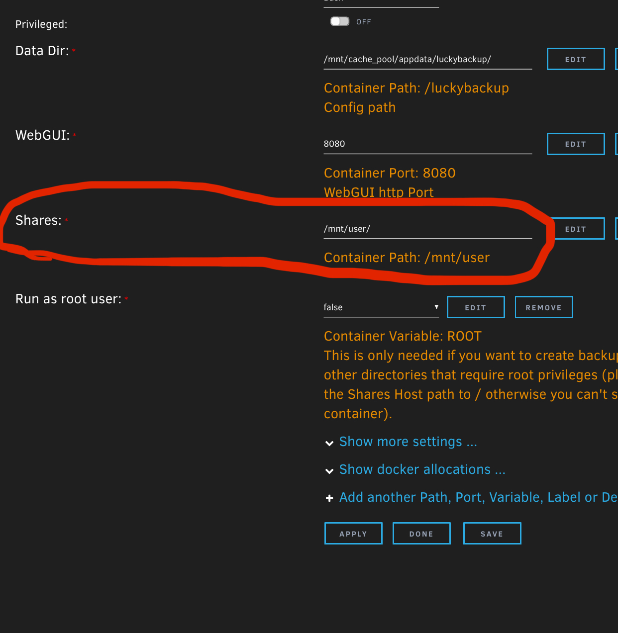

Have you mapped the container path to “/mnt“ instead of the default “/mnt/user”?
If you haven’t done that you will only be able to see user shares and not disks.
No luck. When I open Lucky Backup UI and point to /mnt, all I see inside is /mnt/users, I don't see /mnt/disks at all.
Did you change the volume mapping to point to /mnt or just try going to /mnt inside the container without changing the mapping?
Just like @itimpisays, do you mean to say that you changed the containers path mapping?
Because what you describe sounds like it’s still mapped to /mnt/user.
Share points to /mnt/, but I'm still only seeing /mnt/users, so /mnt/disks is missing.
Ok I see what I was doing wrong. Problem solved. Thank you both.
