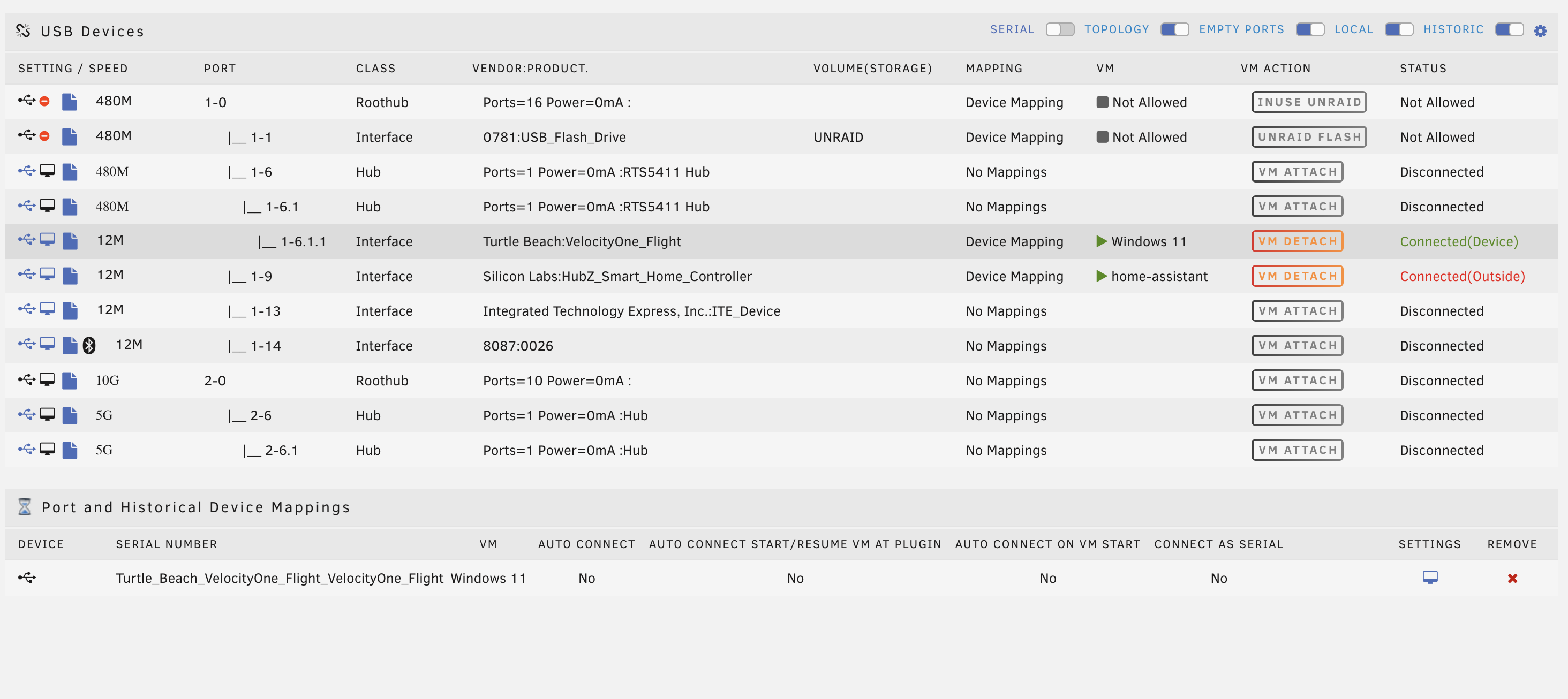

I have a Windows 11 VM running for gaming. It runs games well and hasn't had any issues since I set it up.
I recently purchased a Velocity One Flight controller to use with MSFS. When I plug it into unRaid without attaching it to the VM, the device powers on and lights up like it should. However, when I attach it to the VM it immediately appears to powers off/crash (the LEDs on the device all shut off). It shows up in Windows Device Manager correctly and shows up when I run joy.cpl correctly as gaming devices. However, only the x axis is picked up by windows. No button presses or other axis work. The only reference to something like this online I can find is this reddit post. I have tried killing some processes like the user mentions, but no luck.
When I plug the device into a windows 11 laptop it functions correctly, showing up as the device and not powering off, so I don't believe the device has a problem.

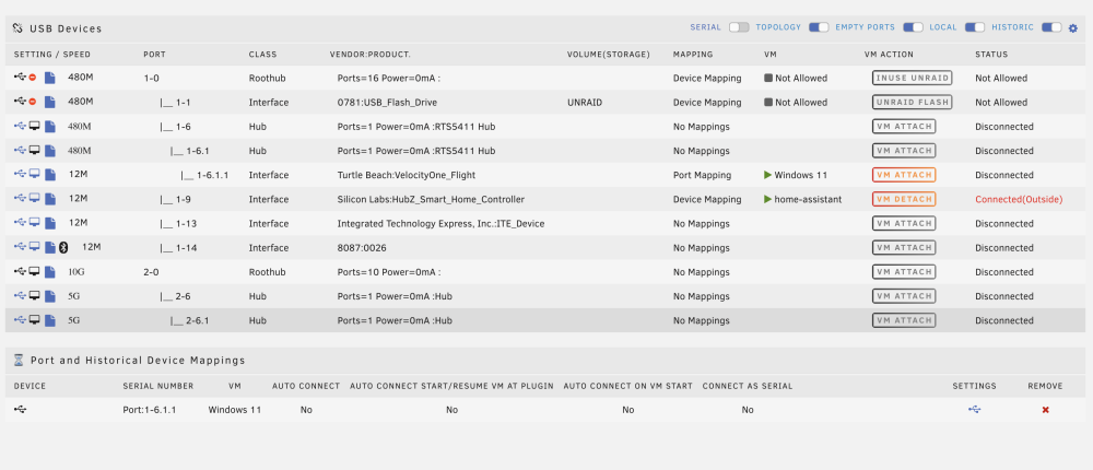

I have tried in Windows;
- turning off USB power management (in power settings and device manager)
- driver updates / uninstall / reinstall
- firmware updates for the Velocity One Flight itself
I have tried in unraid:
- attaching device in VM settings
- attaching device using USB Manager
- every USB port I have
I have not tried passing through the entire USB controller because my system only has one and I'm out of PCI slots to add one.
Any tips, suggestions, things to try? Thanks!

Yes, it only shows as one device in lsusb (in the VM Windows Device Manager it shows as a composite USB device and two game controller devices).

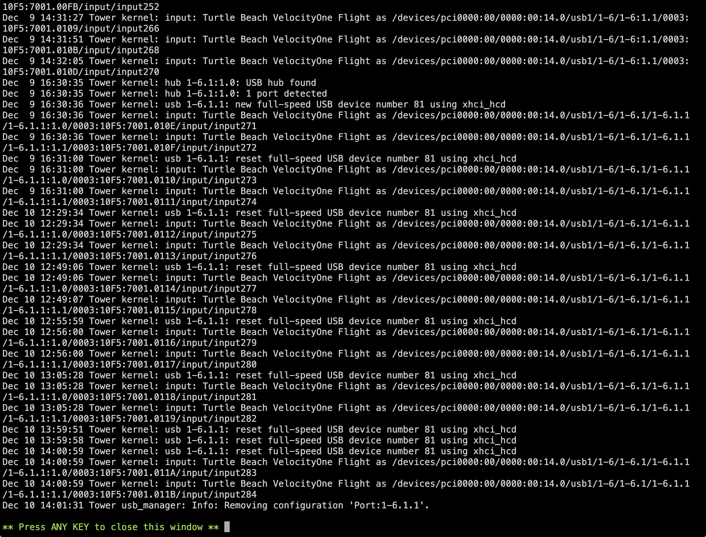

Any errors in syslog. May not getting enough power from the port. Have you tried others?
maybe post diagnostics
Yeah, I've tried all ports.
Attached diagnostics.
There are some errors; it looks like they occur when I detach the device.

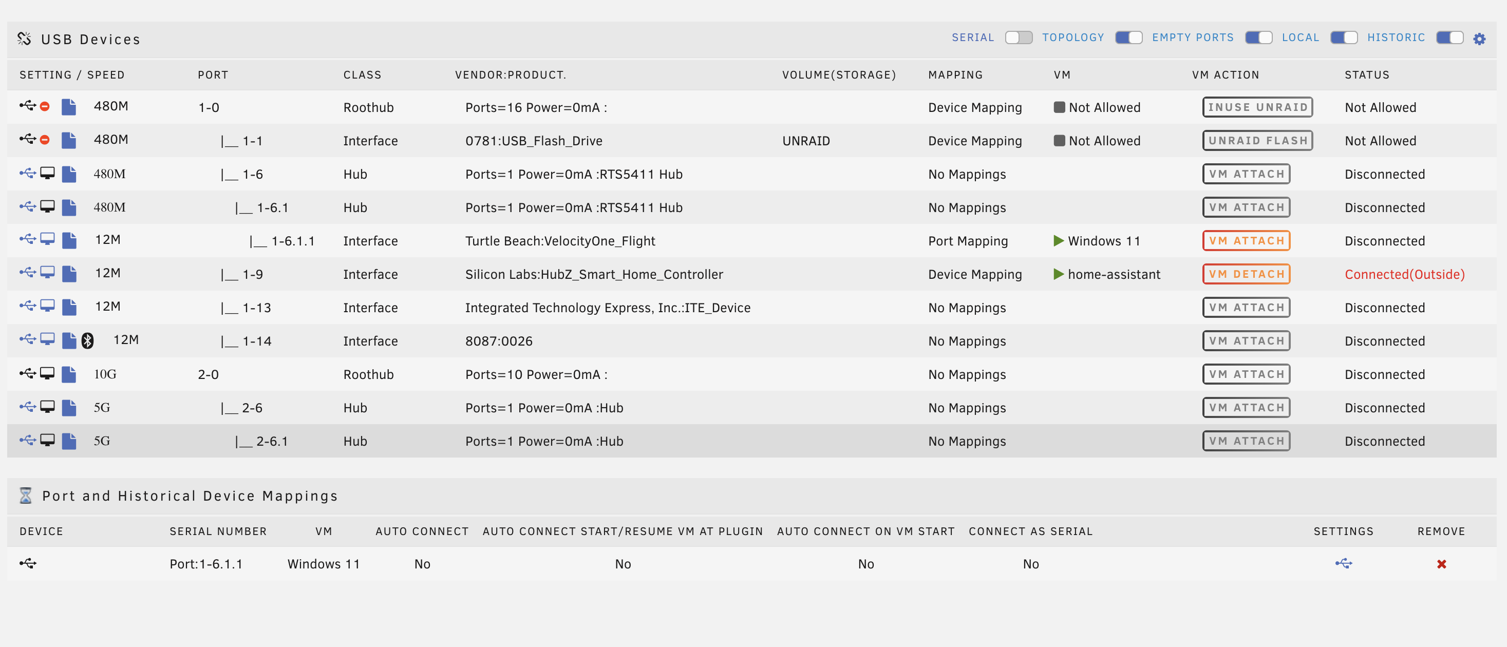

1 hour ago, SimonF said:
If you still have USBM installed can you screen prints for pages?
I do. Is this what you're looking for?  One is unattached, one is attached, and one is the device's log. Let me know if I can provide anything else!
