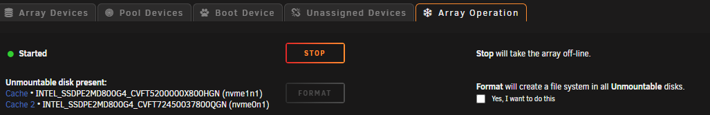

Not cool.  So naturally, I reboot and when i manually bring up the array, it comes up without cache.  So no docker or VMs, the data in the array is untouched - huge plus.
When I got to Fix Common Problems I see this message:

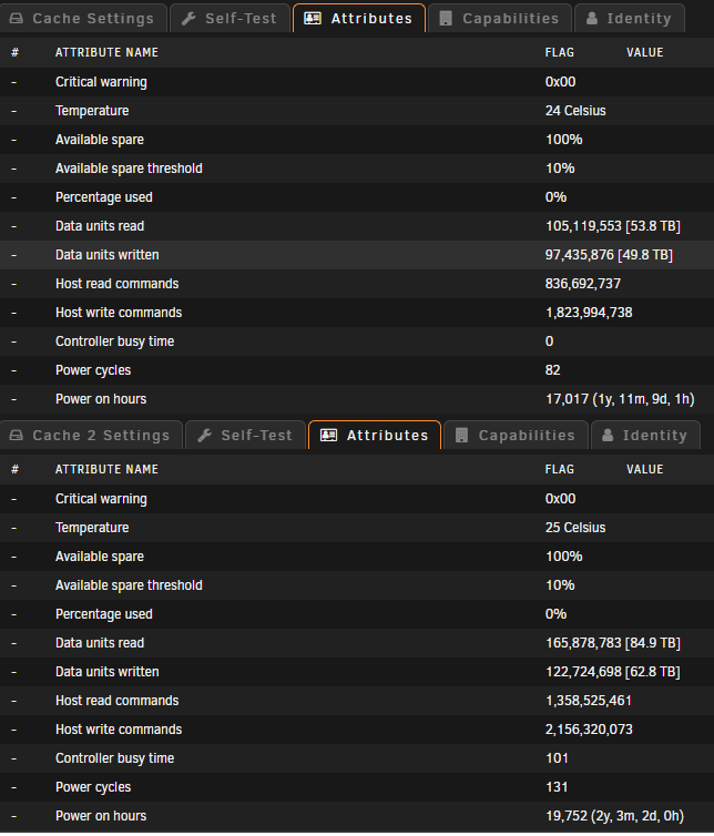

My dual NVME cache reports this:
All my docker and VM's should be there but of course, I don't know what to do at this point.  The above errors links me to this particular forum if I'm dealing with the "unmountable disk..." error.  So here I am.  I hope that I can get some help for this one, i rather not start building both docker and VMs after a format.  I've attached my diag to the thread.
