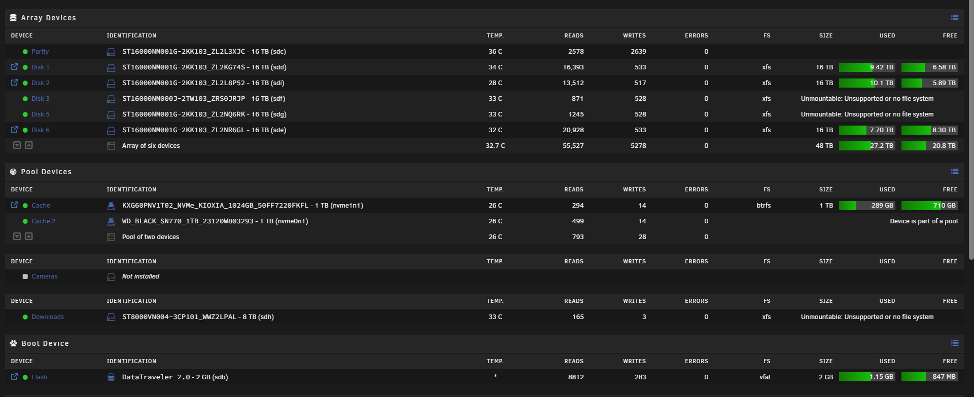

I'm on unraid 6.12.5 and had to shutdown my server. After restart, I'm met with this:
Did I just lost 3 drives full of data (and then all data from these array)? I had read error on other drive (not even these) before shutdown.

No reason to assume just because a drive shows as unmountable that anything has been lost.    Handling of unmountable drives is covered here in the online documentation accessible via the ‘Manual’ link at the bottom of the GUI or the DOCS link at the top of each forum page. The Unraid OS->Manual section in particular covers most features of the current Unraid release.
the question, however, is why the drives went unmountable.   Probably a good idea to attach your system’s diagnostics zip file to your next post in this thread to see if we can spot anything.

Is there something I can do to ID who is ata3?
If I only I could remove all HDD from the cage and then begin the rebuild on that one drive... right now it's saying 6 days for the rebuilt at 16mbps
Is that inside the cage? If yes remove it, if not replace cables.
Yes I'm pretty sure it's one drive inside the cage, but I don't know who is ATA3? Before that I had also ata5 error so the drive I removed from the cage is probably ata5 (the one I'm rebuilding)
Edited by Nodiaque
You'd need to post the diags for us to be able to tell.
ATA3 is currently disk6.
ah, yeah it's in the cage. I guess I have to wait for the rebuild to end before moving another drive
quick question, where can I see that in the log?
lsscsi.txt maps the ATA# to the sdX identifier.
oh nice thanks, I'll keep an eye on that!
