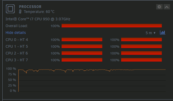

I have the same thing happening since an update somewhere in september/october IIRC. Usually at these times, the dashboard shows this :
Dashboard becomes unresponsive. Everything else also. Can't even power off it doesn't respond (even from a one push on the HW button). And the terminal doesn't load so I can see what happens with HTOP...
Edit : Since the last few months, I managed to get some diagnostics during one of this hang, showing nothing also.
Edit2 : it was before September actually :
Edited by xoC
