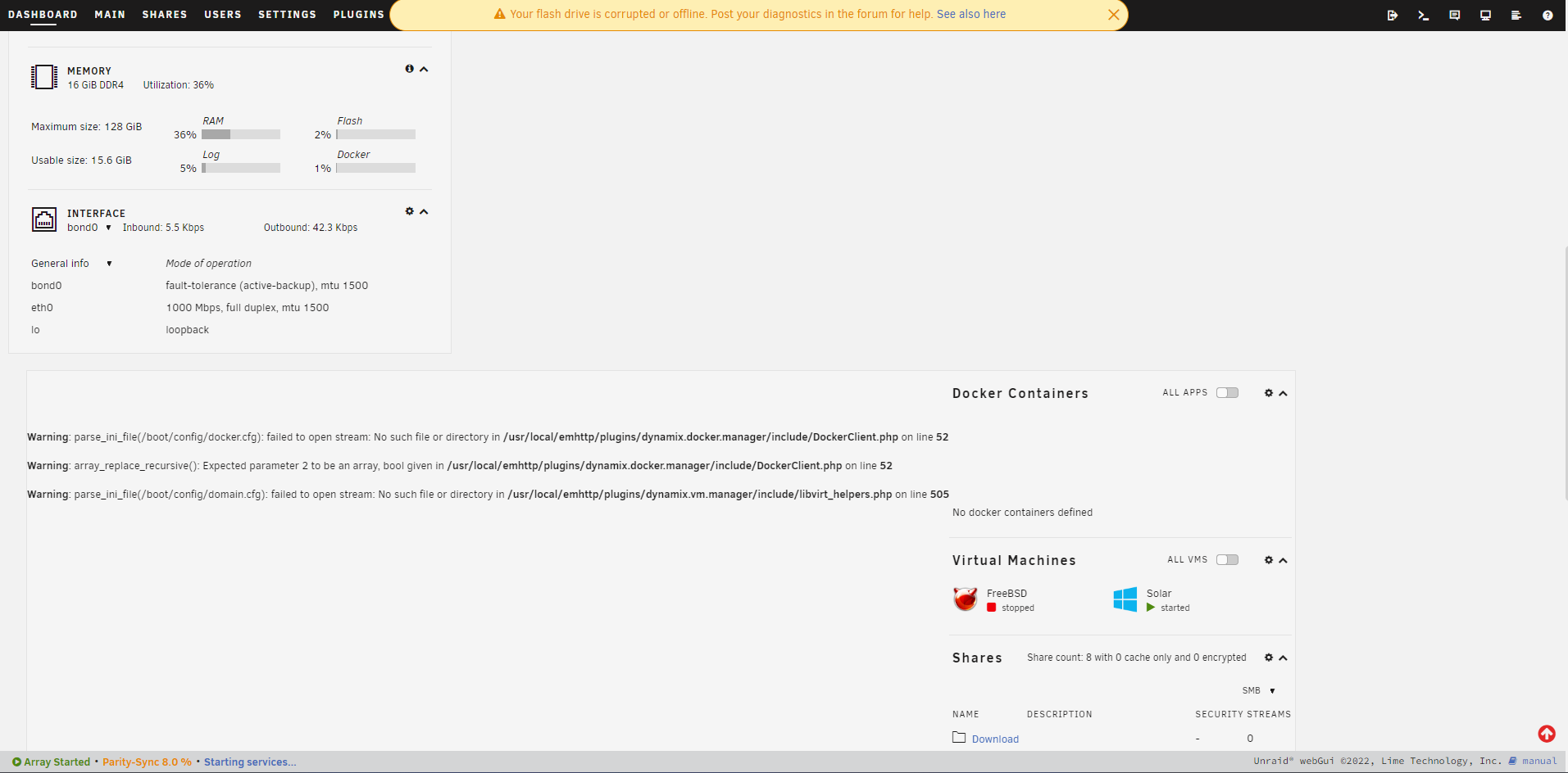

I tried another usb but I have the same problem. Now sae shows me the main page below me and a bunch of errors
