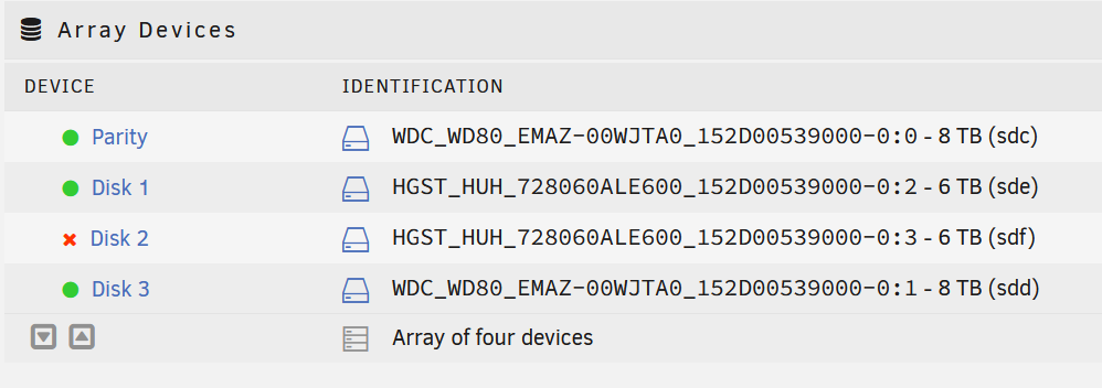

All of that info aside we had setup unRAID and all was working with 3 data drives (2x6tb & 1x8Tb), a single 8Tb parity drive, and a SSD cache drive. We had migrated all of the data onto the XFS array and a parity sync completed but then a few days later we noticed all of the dockers had stopped running and when I logged in remotely to lend a hand I saw errors about one of the 6Tb drives and have attached screenshots of that. I imagine this is a disk failure and that installing a new 6 or 8Tb drive and doing a parity rebuild is what we need to do but I am not 100% sure.

SMART for disabled disk2 looks OK though no SMART self-tests have been run on it.
But, we can't tell from the diagnostics if the emulated drive is mountable. Better to fix the emulated drive if necessary before rebuilding.
Start the array and post new diagnostics so we can see if the emulated drive is mountable.

Unraid disables a disk when a write to it fails. This is because parity is updated anyway so the write (and any subsequent writes to the disk) can be recovered. After a disk is disabled, Unraid doesn't use it anymore. Instead, it emulates the disk from the parity calculation. Reads from the disk instead read all other disks and calculate the data for the read. Writes for the disk update parity as if the disk had been written, so the write can be recovered by rebuilding.
Also, if a disk can't be read, Unraid will get its data from the parity calculation by reading all other disks, and try to write it back to the disk, which can fail and disable the disk.
So the data disk is out of sync with the array.
SInce SMART for the disk looks good, almost certainly USB caused the disk to disconnect, which lead to this failure. But the syslog in those initial diagnostics doesn't include any I/O errors that I would expect to see. Possibly the system had been rebooted after the disk became disabled, and the system was allowed to run for several days like that since that syslog goes back to Dec 2.
Rebuild is the normal way to get the array back in sync. Since the disabled disk is the disk out-of-sync (due to write failure) that is the disk you would rebuild.
Another way to get the array back in sync is to forget about that failed write, trust the contents of the disabled disk, and rebuild parity instead. But there is some chance the failed write could be filesystem metadata which might mean corruption.
If this weren't all on USB I wouldn't hesitate to recommend rebuilding the data disk on top of the same drive since it seems to be OK. Might be safer to not trust USB to rebuild on top, but instead rebuild onto another disk and keep the original as is in case of problems.
Or rebuild parity instead since it contains none of your data. But that would mean any writes to the data disk since it became disabled would be lost.
