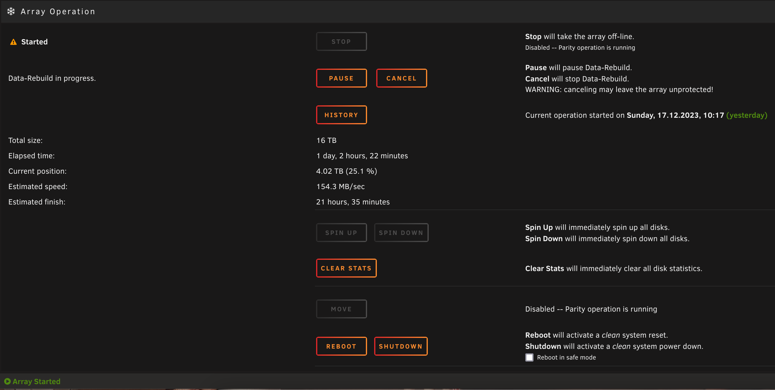

So, I followed @JorgeB's advice and initiated a new data-rebuild process. That was 4 days ago. Three days in, the server started behaving weirdly, as in no sound from the drives reading/writing, even though the process was supposed to be under way. Then I lost external access to all the services I was running (Docker containers). I couldn't even reboot the server, neither from the button on the Dashboard, nor from terminal. That lead me to force a shutdown.
Afterwards, I mounted the array and let the data-rebuild process to start again. I can hear the drives running now and when I last checked 3 hours ago, it showed 25.1% completing. However, at this point, 3 hours in, the numbers haven't changed (even though the disks are being written to/read from).
Furthermore, I can't even download the diagnostics report: the process is stuck at

EDIT: the problems with the docker services began again – the drives stopped making a sound and all of my external applications are no longer accessible, the error being 504 gateway timeout.
