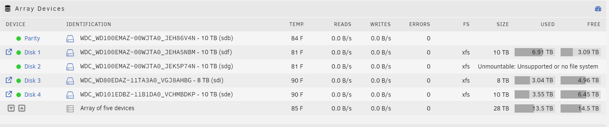

Hello Unraid Family,
I need some help with my server.
I've been struggling with system crashes for awhile and I upgraded my mobo/CPU/memory but kept my a Supermico Case, raid controller and thumbdrive.
The migration went pretty well and after I was moved into the new hardware, I also deleted and rebuilt my CACHE and Docker Containers as I had quite a few BTRFS errors on that I could never get rid of.
Post migration, CACHE rebuild and Docker file rebuild, I continued to have issues with system crashes and I noticed yesterday that a bunch of my SHARES were no longer accesible after the array was started.
Disk 2 shows that It's unmountable with the error message "Unmountable: Unsupported or no file system"
I looked through the logs, and I think this is what's going on with Disk 2 in the Array is that's it's corrupt but I don't what to run xfs_repair because I'm really not familiar with the command.  The SMART data reported on that disk looks OK, maybe this is an issue with the repeated shutdowns.
You can run it from the GUI as described in this section of the online documentation accessible via the ‘Manual’ link at the bottom of the GUI or the DOCS link at the top of each forum page. The Unraid OS->Manual section in particular covers most features of the current Unraid release.
Hello itimpi,
Thank you for the quick response and pointing me in this direction to do this test, I had no idea that could be checked per disk, I had always done everything in UnRaid at the Pool/Array level.
Here is the results of it with the -n and without the -n.
I see two .jpeg files (cell phone pictures likely) in results below that would be lost and my backup strategy has them, but most of the data on the drive is not backed up and that's what I don't want to loose.
When I run without the -n, the prompt notes that there will be data loss and wants me to run with the -L option .
If I run with the -L option, can I expect the data loss to be just the Image Files identified in the -n step or is there likely/probably to be more data loss?

You need to run without -n and add -L (Unraid has already failed to mount the drive) to get the repair done.   Afterwards you need to start the array in normal mode and see if you have a lost+found folder which is where the repair process puts anything it cannot figure out.
Thanks itimpi 😍, array is running and back on-line and I don't see where any files are lost or gone from the array.
If you do not have a lost+found folder on the dtive then that normally means all data has been recovered with no data loss.
