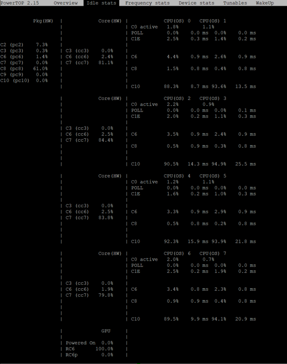

September 20, 20242 yr Hi guys. I am facing the same issue on my H610i with i3-12100T. My system is idling at about 11w and reaching c state C8, which is ok for me. When i connect my "SONOFF Zigbee 3.0 USB Dongle Plus,TI CC2652P + CP2102(N)" stick it just reaches C3 and power consumption is about 20W. Have you guys found an workaround to this issue? I have found out that the issue seems to be Intel related because of the USB full speed devices (12 MBit/s), which the usb serial CP2102 chip on the stick is. Here are some references: https://github.com/Koenkk/zigbee2mqtt/issues/3140 https://community.intel.com/t5/Processors/Poor-power-efficiency-with-B660-B760-boards-and-active-Full/td-p/1565137 https://community.intel.com/t5/Processors/Poor-power-efficency-with-B760-and-active-Full-Speed-USB-devices/m-p/1628022 Because i don't think intel will solve the issue quick, here are ideas for workarounds, which i will try: Try every USB Port on the MoBo -> Tested, doesn't solve the issue Use an old self powered USB 2.0 HUB in between -> Tested, doesn't solve the issue Use an self powered USB 3.0 HUB in between -> Tested, doesn't solve the issue Use a PCIe to USB adapter which supports ASPM -> not tested, but probably will not work Use an SLZB-06 PoE network zigbee adapter -> !! Hurray !! That is an workaround!!!! I have migrated (cloned IEEE) my zigbee network (132 devices) from the sonoff to an SLZB-06 (which has the same zigbee frontend CC2652P and an PoE ethernet port) flawlessly. The CPU now reaches C8 again! So yes, this is a workaround and Intel has an serious USB issue there! Here are the stats with running Z2M conrainer + SLZB-06 (PoE): Edited October 4, 20242 yr by pOpYRaid
