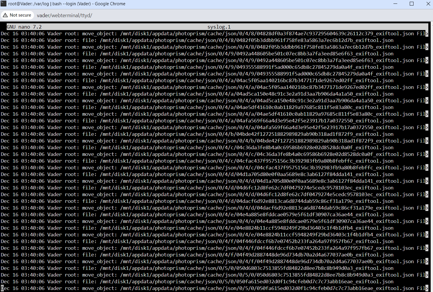

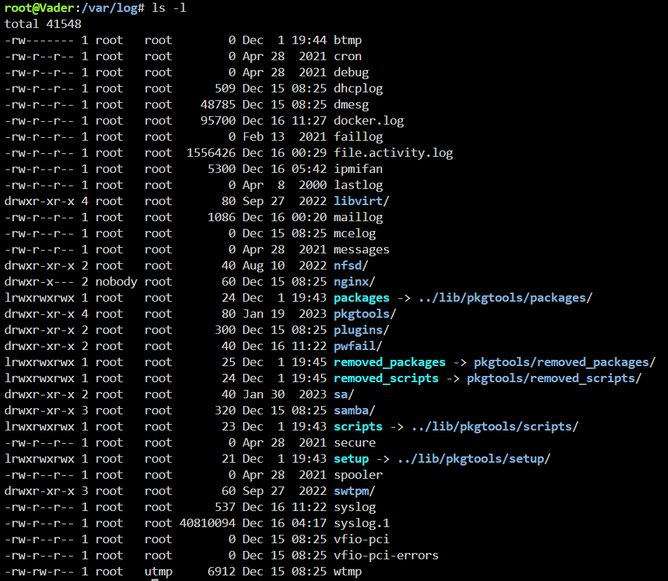

I have been having trouble to keep the server up for more than a couple of days as the log keeps filling up.
I stopped all the containers and run it as bare-bones as I could and it still fills ups. Looking at the logs, I noticed syslog growing in size:
image.thumb.png.e49c53b774e2871feda0c1515125d853.pngIt
It seems that this is because mover errors when trying to move things from the cache to the array. What could have caused it and what can I do about it?

Please post the diagnostics, actual error is cutoff on that screenshot.

Having a bit of trouble with the diagnostic tool as it runs out of memory while generating it.
I am attaching the syslog on its own and will give it a reboot and run the diagnostics again. I suspect it has something to do with the mover as the log size stays reasonably constant while I watched it.

File exists
Mover won't move any files that already exist on destination, you will need to delete one of the copies.
