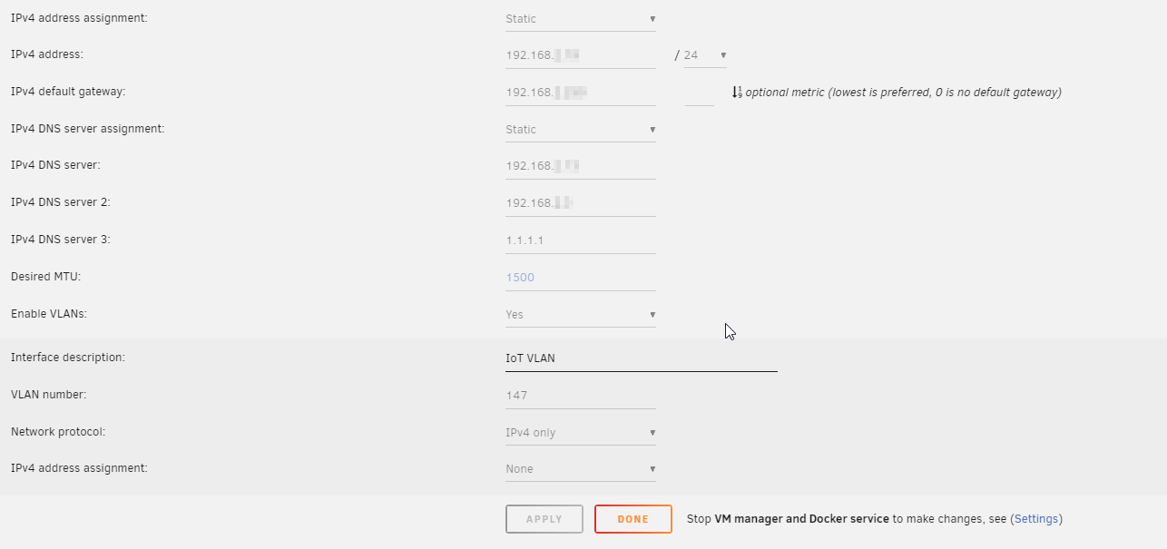

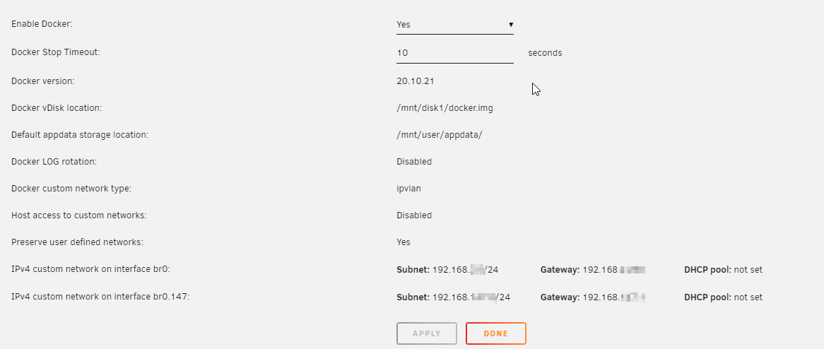

Here are my network and docker settings:
1543077535_2023-12-1608_58_35-unRAID_NetworkSettings.thumb.png.799955a02f4d835be18e51c8afc25a14.png897238016_2023-12-1608_57_05-unRAID_DockerSettings.thumb.png.c98501774725017c5581cd9222a6d507.png
Does someone has an idea regarding that issue?

Try enabling "Host access to custom networks" under Settings -> Docker (need to disable Docker first).
