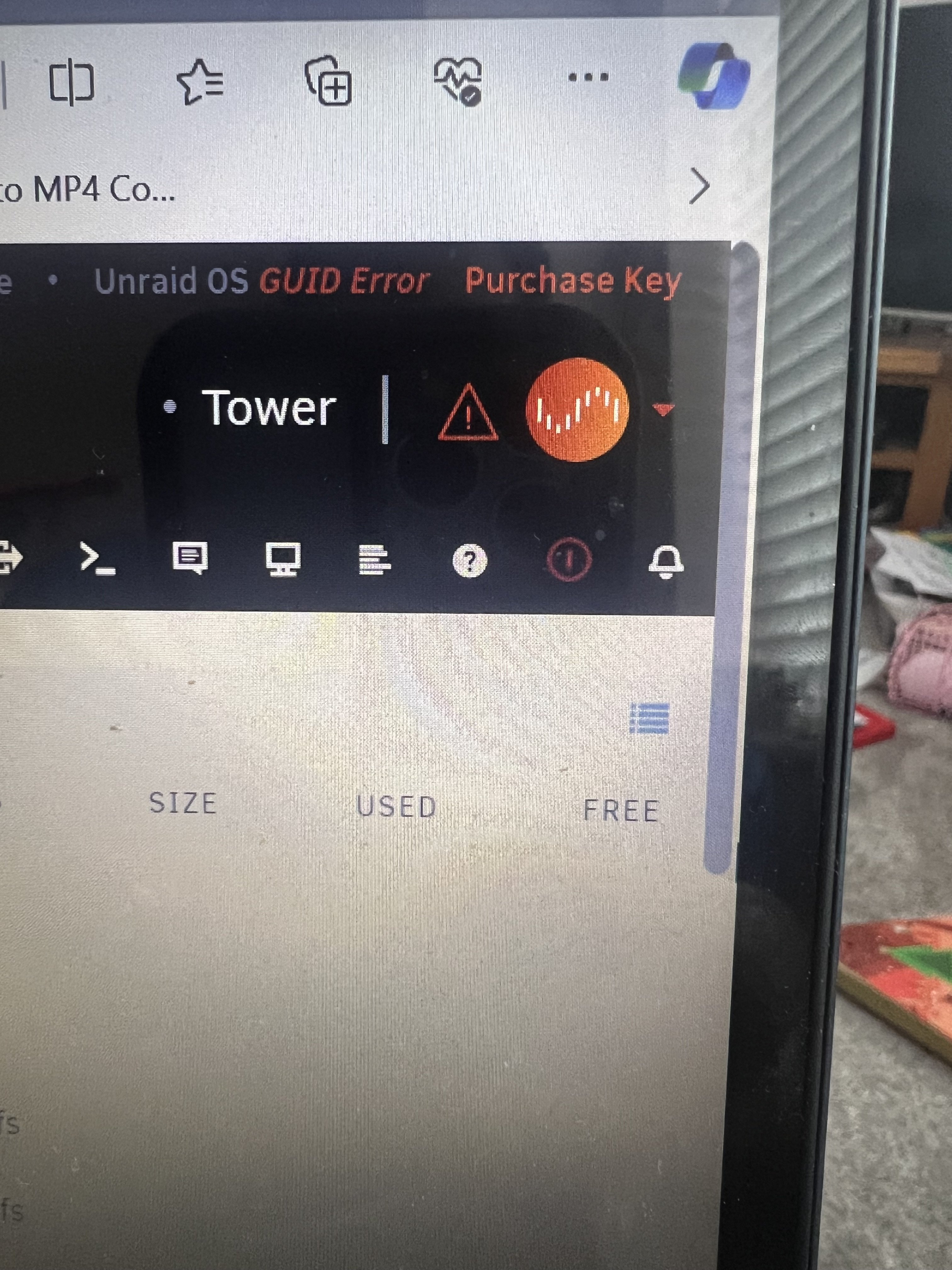

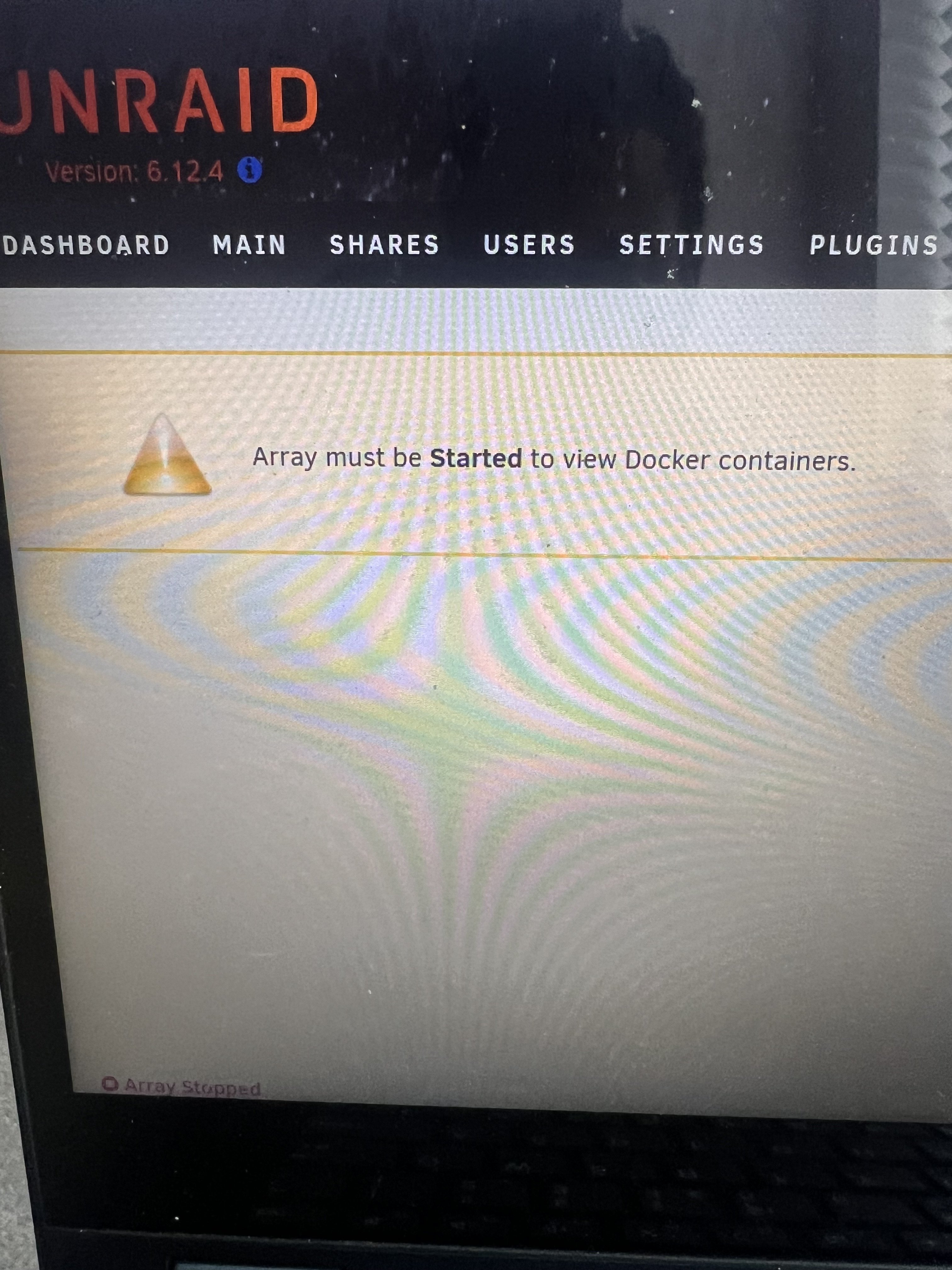

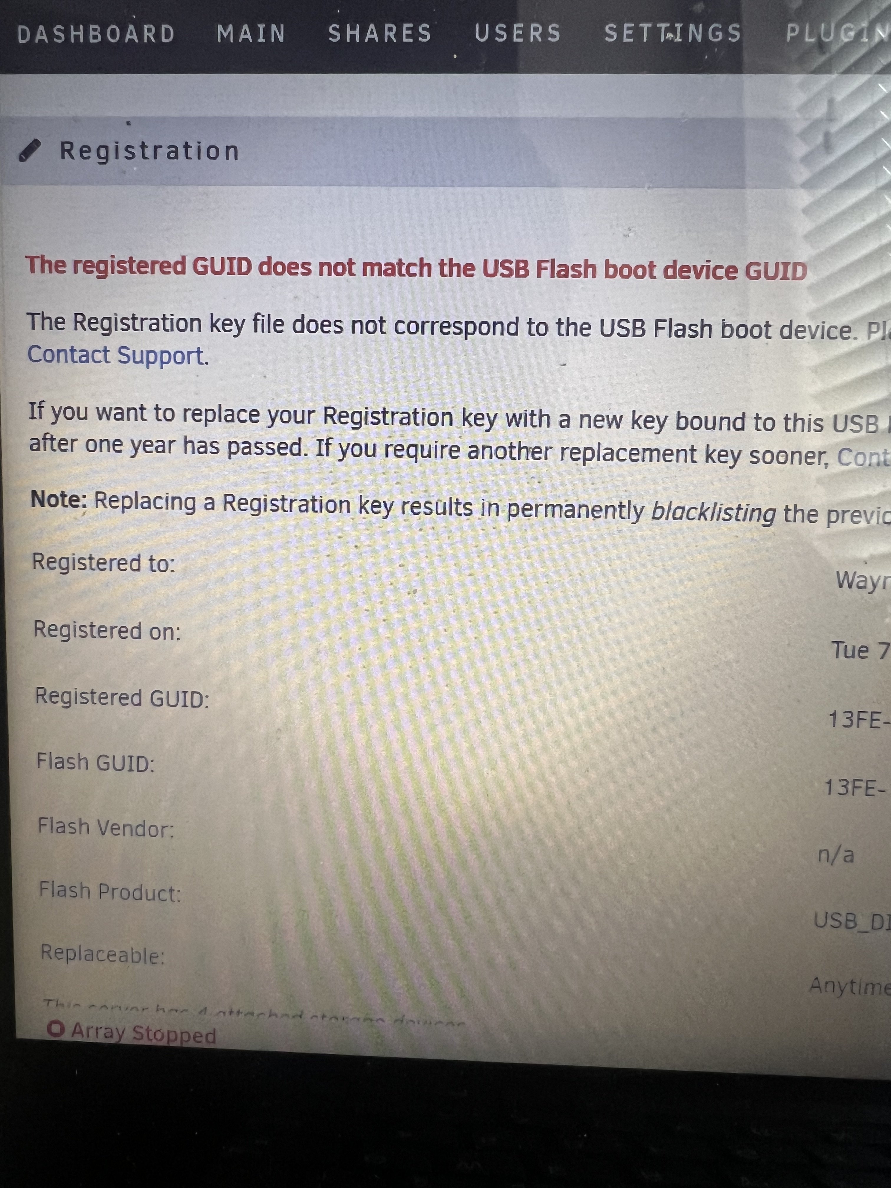

I am new to the Unraid game but had a trail period of Unraid then went too upgrade paying for a licence. When I tried to add this via the GUI i got errors which then stopped my array and said the registered guid does not match the usb boot device guid. I can now not get into my shares and am worried I am going to lose the data on my drives if anyone can help resolve I would be so grateful I have attached screen shots below.IMG_6365.thumb.jpeg.ac0d809b154f984ef783a8a77fafe9bd.jpegIMG_6365.thumb.jpeg.ac0d809b154f984ef783a8a77fafe9bd.jpegIMG_6365.thumb.jpeg.ac0d809b154f984ef783a8a77fafe9bd.jpegIMG_6365.thumb.jpeg.ac0d809b154f984ef783a8a77fafe9bd.jpeg
As long as you know your disk assignments or have a backup of the config folder on flash your data should be fine assuming there is nothing wrong with it already.
What brand flash drive are you using? Are you using the same flash drive you have been using? Are you sure it has a unique GUID?
