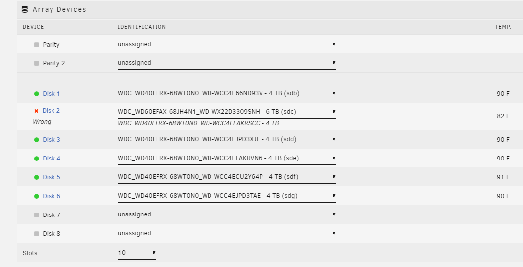

Go to drive 2 and selected 6TB drive.

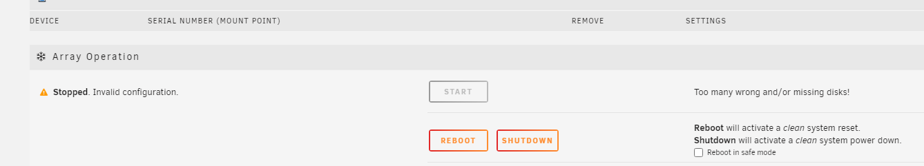

At this point I am stuck - as there is no option to accept this change and start the array.

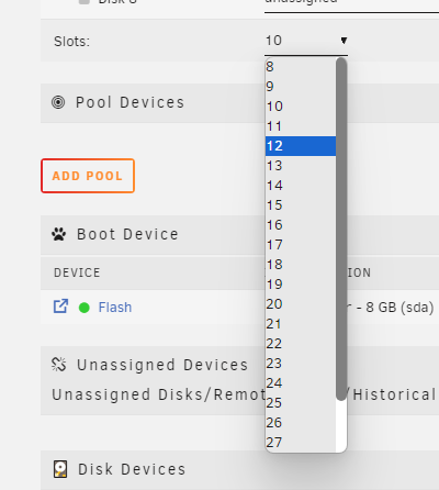

The Array devices list shows 8 disks - but the MB can only handle 6 - so there are NOT 2 unassigned disks.  Nor can I change the slots drop down to 6 (the lowest it goes is 8)

Since you have no parity you can't rebuild to a new disk.
If you need to change disk assignments, Tools - New Config.
You might be able to copy files from the failing disk as an Unassigned Device.
Thank you.  I thought that might be the case - but wanted to double check.  This is a backup NAS for my primary NAS - so I will not lose anything - rsync will do its nightly run and it will just take awhile to replace any missing files.
