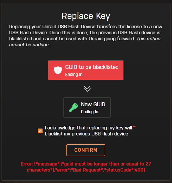

I tried to renew the the licence (Tools->Registration Button Replace Key) but I get an error:
Error: {"message":["guid must be longer than or equal to 27 characters"],"error":"Bad Request","statusCode":400}

Seems like a problem with the GUID  of the new flash drive.
What brand is it. Does it have a unique GUID?

Same drama here.
It doesn't' pick up the GUIDs in the pop up either.

I was able to work around my issue by doing 2 x things, not sure which one was it. But first I tried in Firefox, which had no sessions cookies already, so was a fresh login. When I went to Replace Key, I had to log into my unraid account and give a fresh 2 factor code. After logging in here, I was able to see both ID's and everything went smooth from there.

It definitely has an issue with Chromium based browsers AND 2FA not enabled.

I was able to recreate this issue. It's definitely a Chromium based issue. I'm working on a solve for this.
In the mean time Firefox or another non-Chromium based browser should be an alternative solution.
Chromium fix has been deployed to the account.unraid.net site.
It works with Firefox. thanks
