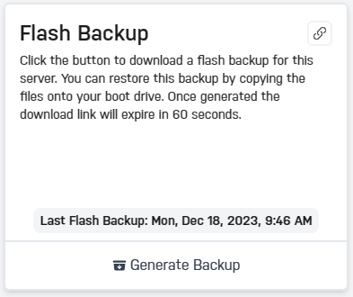

Also a failed USB key (?) - It has booted into UnRAID, which surprises me if the key has failed! I have checked on Connect and it shows the last backup as this morning when I shut the server down;
I am assuming these are 2 completely separate faults and a replacement HDD and USB key will fix things?
If I get a replacement USB key, am I better off copying the 'failed' one or restoring from Connect?
