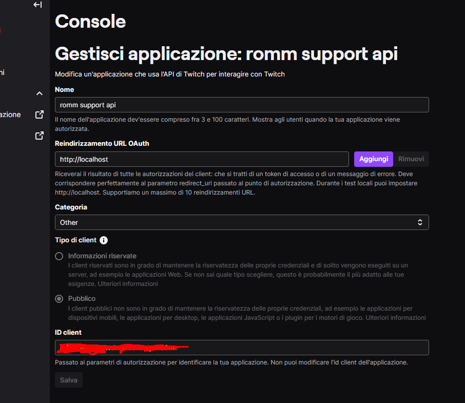

7 minutes ago, dhstsw said:
Hi there,
Following the guide:
4. Manage your newly created application
5. Generate a Client Secret by pressing [New Secret]
Under the manage application i don't have any "new secret":
Select the other option (not Pubblico/Public).
That worked.
Thx.
