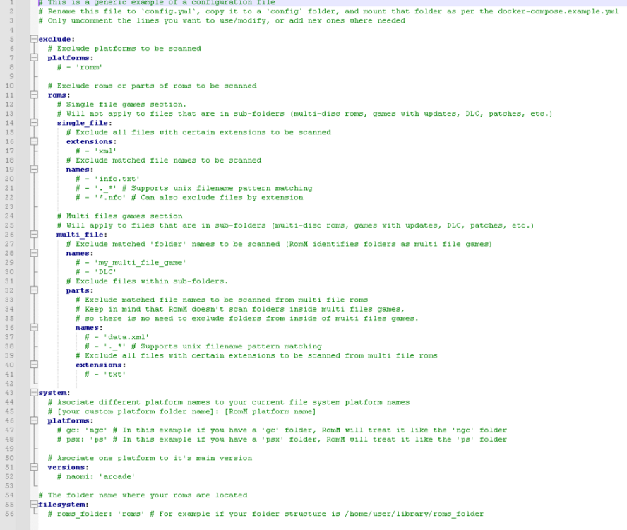

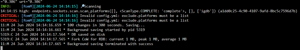

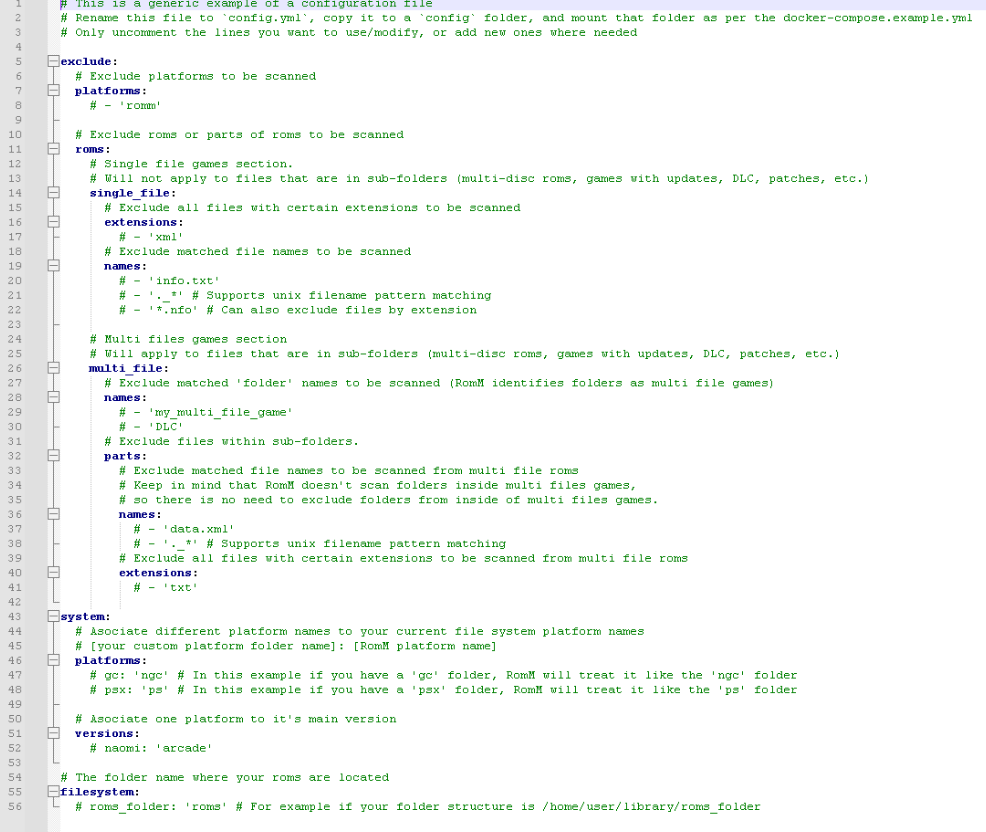

i keep getting the error message
"CRITICAL: [RomM][2024-06-24 13:59:31] Invalid config.yml: exclude.platforms must be a list"
I copied over the config from the github and here is how it looks
I also cant seem to find any games when I scan but that may be a folder layout

Getting the same   error as mstrlargo. App loads fine with blank config.yml but as soon as I copy the example .yml and restart I get the Invalid config.yml error.
Found my solution. Used this example file instead of the stock one.
https://github.com/rommapp/romm/blob/release/examples/config.es-de.example.yml
Think you need to specify all your platforms in the config and it doesn't like the # commments.
