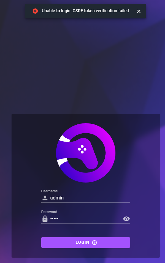

I've tried all 3 different config files from the github.
I keep getting this error when trying to login.
Don't know how to get this resolved.
Edited by QuiveringArcher
Only way I was able to fix the login issue you're having is by clearing your cookies. It seems once you do this, you're good. I also think this bug might've been fixed in the latest release of RomM but I'm not 100% sure.

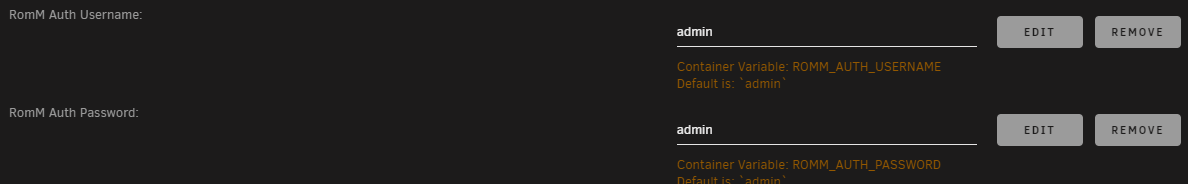

Is there a dummies guide to setting this up? I've installed mariadb alongside it but I can't seem to get Romm to run.
Any luck? I have the same issue. Nothing I do fixes it
Getting this error as well
