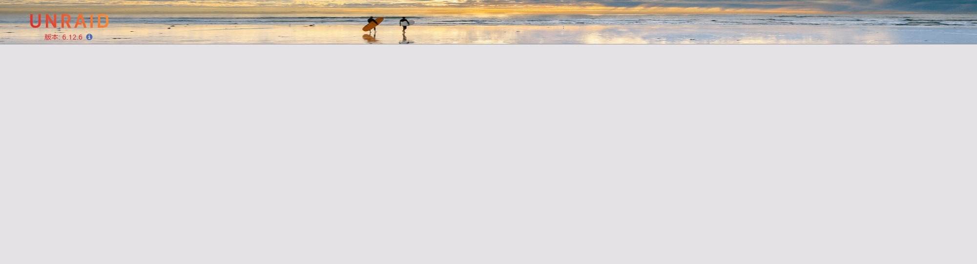

Only banner header displayed in WebUI
I upgraded OS to latest version recently and made few changes in settings, I didn't remember exactly the settings' name.
Then I got below output after refreshing page. The same output even by hard reboot.
I've tried to navigate to /apps, /settings or any other path I remembered, but still the same.
But the interesting thing is that page gets back once I pulled out USB stick. And it returns to the same output of above after I insert it back to machine.
May I know if anyone faces this issue? Any solution available there?

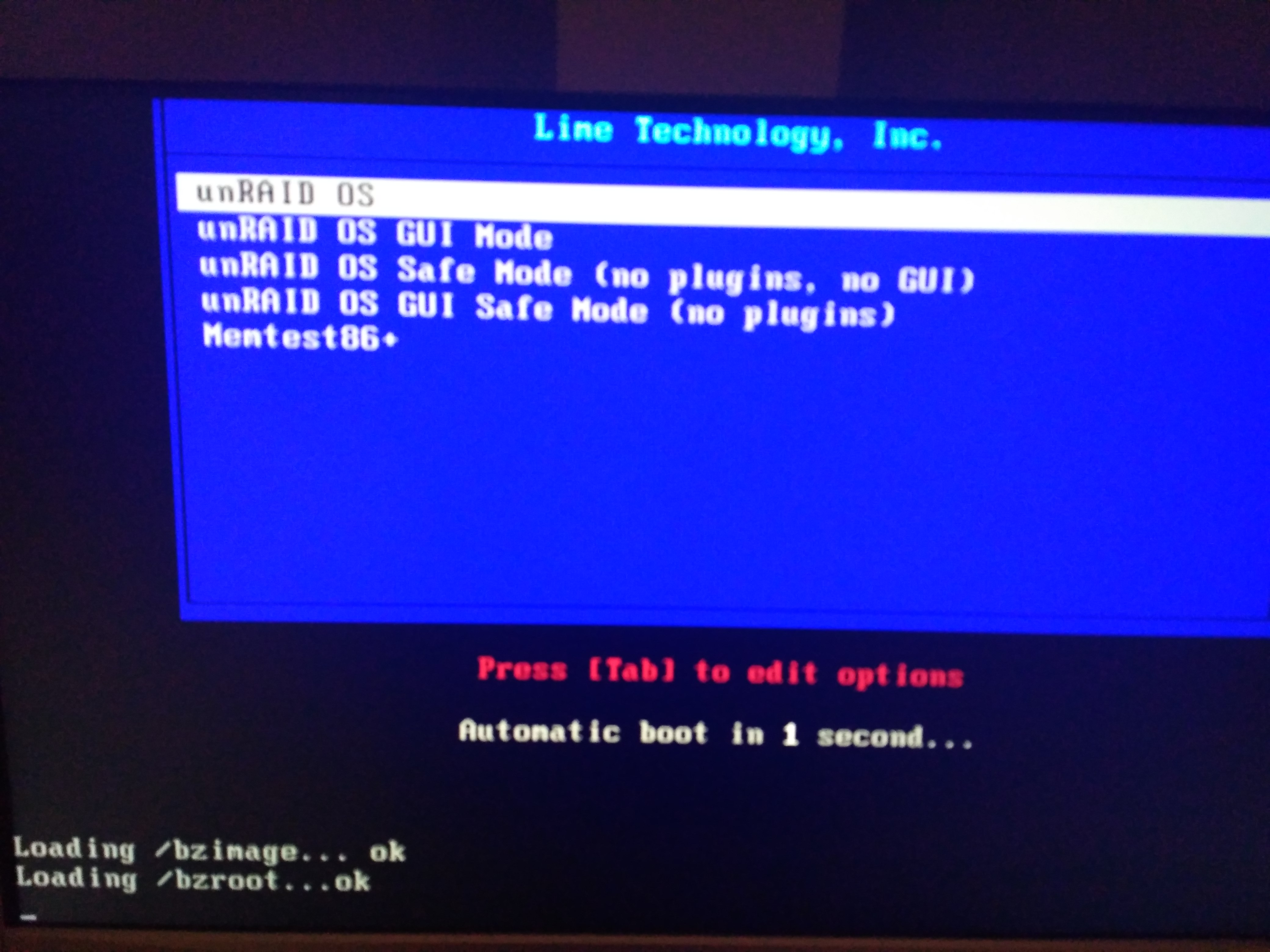

Also try booting in safe mode.
May I know how to do that?
It's a boot menu option:
Thank you. I will check it.
@JorgeB I've tried to boot machine in safe mode and it works good. But the problem is that everything just gone once I boot unraid without safe mode. With this test, I guess the cause might be the plugin? Am I right? If this is the case then how can I fix it?
Thanks,
Ok, I got it fixed. The cause is plugin which named dynamix.unraid.net.plg, the GUI just gets back once I removed this plugin by plugin remove command in terminal.
