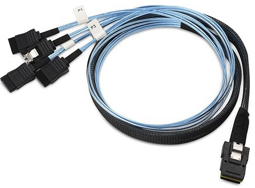

Hi Guys,
I have a SuperMrico XDP1 motherboard (Dual Xeon CPUs). The board comes w/ three of the SAS connectors with the 4 SATA cables coming out.
I also have a couple of Dell LSI controllers that have been flashed to IT mode. I have tried switching the SATA data cables around between the on-board and the adapter cards w/ the same results.
