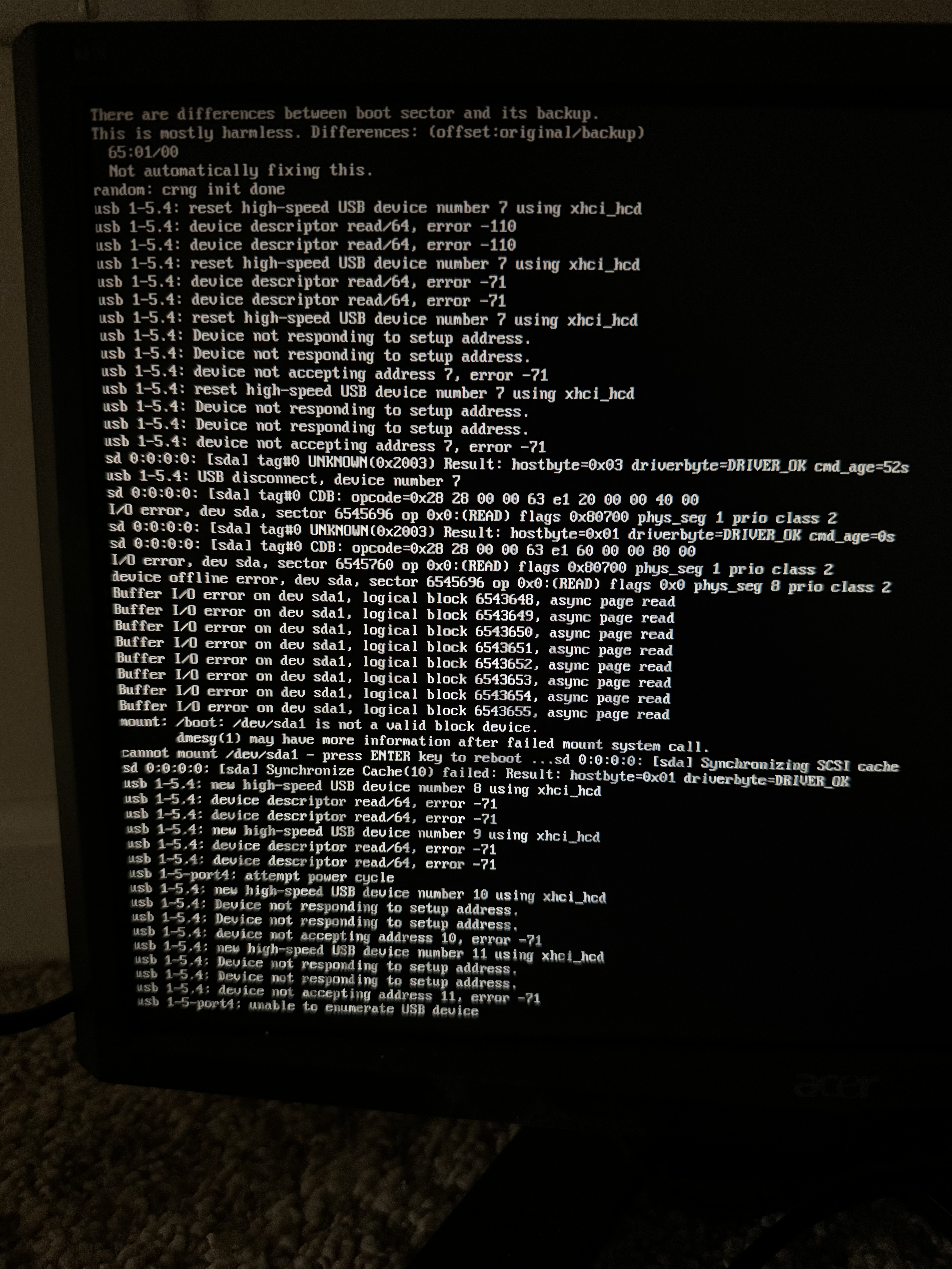

About two weeks ago I noticed random reboots about once a day or every other day. A few days ago it stopped rebooting and I was getting the errors you see in the attached picture. The errors seemed to follow the port my usb was connected to. I reformatted my usb and rebuilt with a backup. The random reboots continued but I no longer got the boot errors(in the pic).
Yesterday I got a new san disk ultra usb. The cruzer glides seem to be preferred but Best Buy was out of those. Today the system had yet another random reboot.

Server rebooting on its own, vs hanging or crashing, it's a usually a hardware (or power) problem, you can enable the syslog server but if it's hardware most likley there won't be anything logged.
Memtest did not uncover any issues. This issue is rather annoying so I’m going for a shotgun approach rather than a methodical change one thing at a time. Next up bios and a new psu.
Memtest passed so I think a power issue is likely. My psu is 10 years old so I’ll replace it.

Unfortunately passing memtest is not always a definitive (whereas failing is) test of memory.
