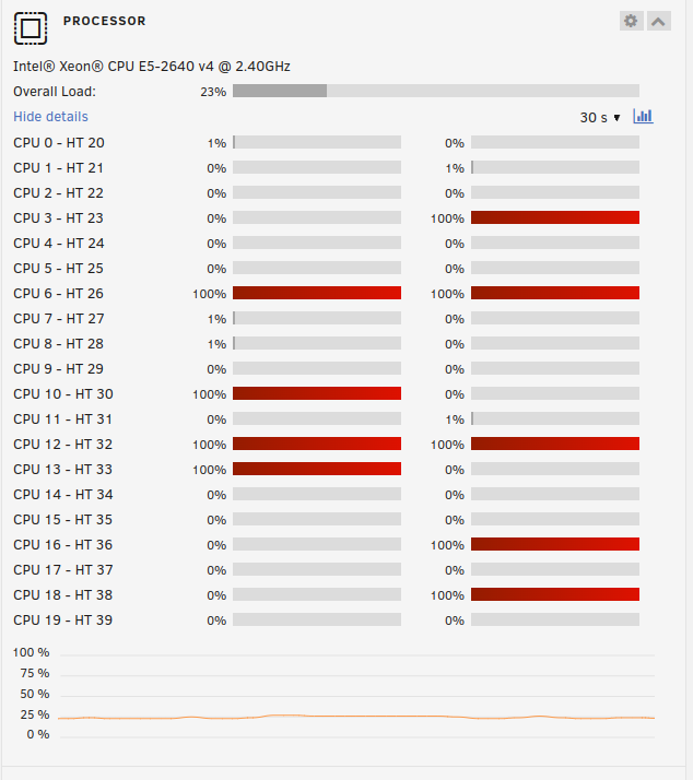

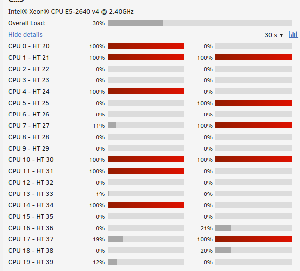

Hello all... I have been having an issue with my system for a while now... The system randomly hangs at various times but I suspect that it has something to do with btrfs disk pool... Recently I deployed a VM to this share thinking that the issue might have something to do with my dockers and I was going to move them to a VM but in doing so I increased the IO on the disks, causing the issue to happen more often
I have tried shutting down all of the dockers(limiting IO to the btrfs disks) and I did observe the issue persist
Is this normal? Im running all of this on 2x 20core cpus... I know they dont have the fastest clock speed but it should be more then enough to handle what little load I have on this system...
Any suggestions are very welcome...

I feel as if you have ignored my concerns on this thread... I have posted about this CPU issue a number of times in a number of different topics... Here I am trying to figure out as to why the services DP is causing CPU spikes... I even removed this DP and recreated it... but when mover was writing data to the DP, the cpu again spiked for over an hour...
until there is a hint/suggestion as to why this is happening... I will be avoiding a DP in the furture
It's normal for the CPU usage to spike during the mover or any other i/o, since the dashboard graph includes i/o wait.
So it's normal for the system to hang for 2h while mover is running... and when ever a docker wants to write data to a DP? If that's the case I would rather have everything running off of the array because these issues dont exist there
Though that wouldnt explain why I am unable to update around 50% of the dockers while they are hosted on the DP. Since moving them off of it, I have been able to update them. There is something wrong with a btrfs DP... Dont know what's going on but... I dont think it would be normal nor acceptable for a CPU to spike/hang a system while writing to a DP
Depending on the hardware and configuration, for some users heavy i/o can make the server, or some services, look unresponsive, since this only happens to some not always easy to see what's causing it, some users see better results after changing pool devices for example, using exclusive shares whenever possible can also help, failing that you can try to schedule the mover to run during the night, when the server is not being used.
