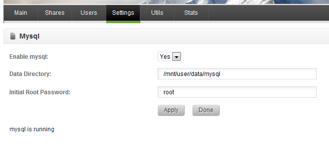

Under the settings screen for mysql does it say it is running?  I've attached a screenshot of mine. If it doesn't say it is running ensure that Enable mysql is set to Yes and click apply. If it is still not running after that, post the contest of the [yoruservername].err file located in the mysql data directory you specified.
