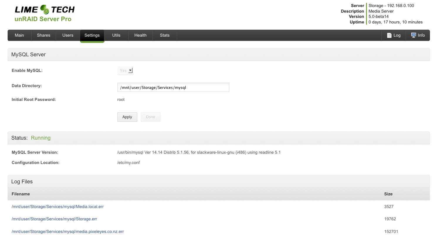

On another note, SeeDrs, do you mind if I make a couple of subtle changes to the PLG file to improve the gui slightly?
Cheers!
Shouldn't be any problem to transfer the files - no harm in trying it out  ;)  Worked for me going from OS X 10.6 Server (older version) to this. Just make sure none of the invisible files go with it. Also make sure the servers are stopped first.
Cheers!
[/quote
If you need any testers... pm me ;). Will be testing your web server out heavily tomorrow and was going to install this older plugin for xbmc DB backend...  would love to have the latest and greatest
If anyone is interested, just did some minor updates to the gui to add in logs. Nothing else changed, see screenshot for details.
