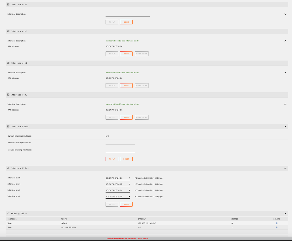

Recently after doing some updates to the OS, I noticed that Eth0 was down.  Checking my equipment I had not seen this before on a server that's been running since 2017.
Board has 4 intel nic's in bond, running over ubiquiti equipment for years.  Checking the cables and everything, they are all fine.  What I can't seem to figure out is why when stopping the VM manager and Docker, I don't see Eth0 settings to edit.  Maybe I'm just getting older and forgetful, but figured I'd take a shot and see if at a glance anyone see's something wrong. (outside of the cables, which I used a line tester)

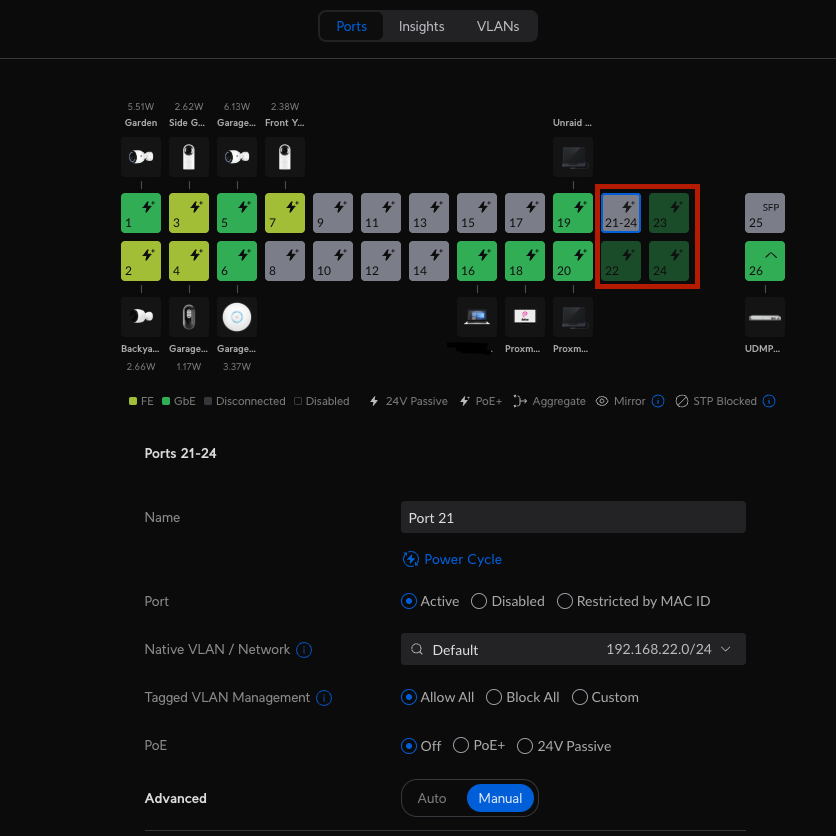

Unifi aggregation on 21-24, eth0 (port 21) offline....

Do you swap the cable / port for eth0 ( port 21 ) from ( port 22 -24 ) to rule out actual problem. ( If cable tester haven't shoot that )
