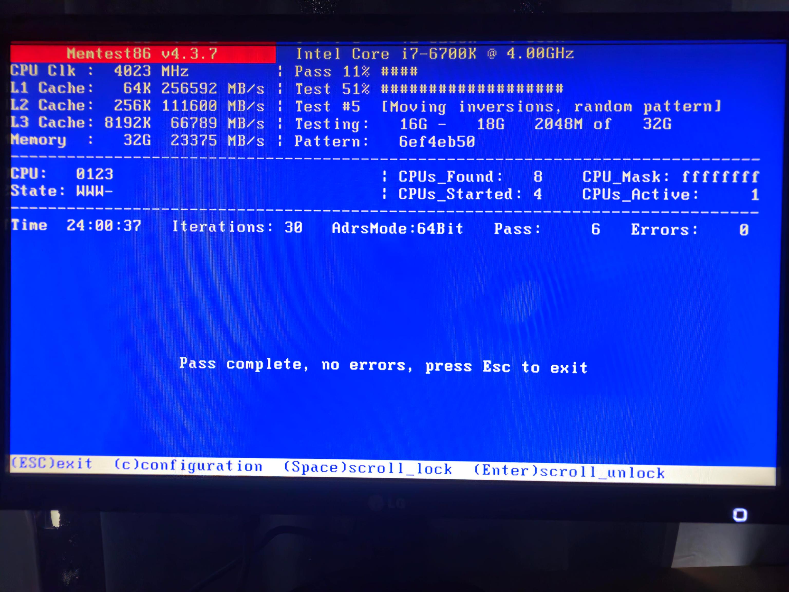

I initially thought it was RAM issues, but memtest came up clean.

1) Run the latest memtest86 overnight with 6 passes succeed (image attached)
- I can attempt a single stick of ram but I am assuming this is a good enough test.

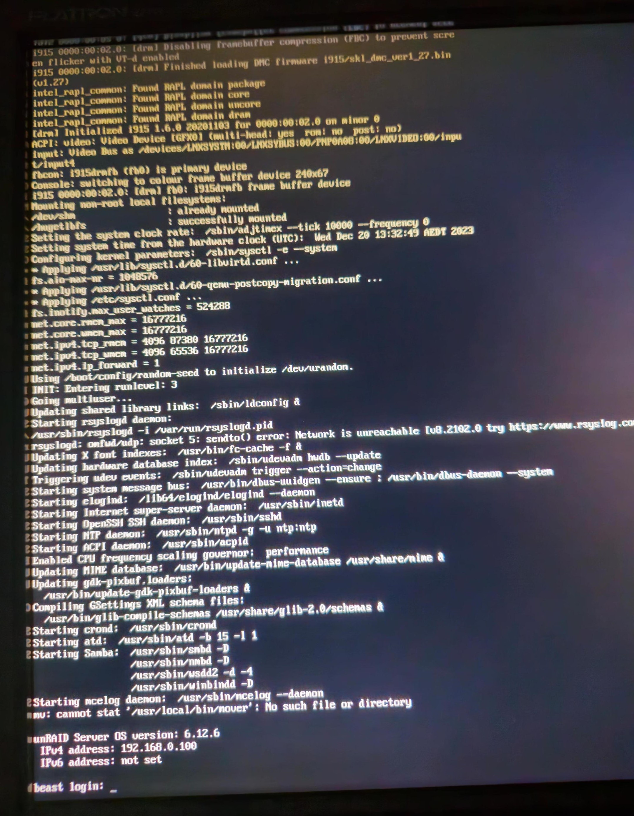

4) Booted up in CLI mode with a monitor attach to monitor standard out

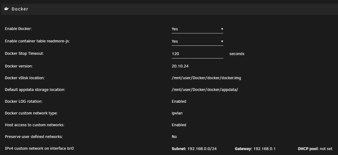

5) Switched to ipvlan in Docker settings and forced upgrade/rebuilt all docker images

Memtest results
Docker - ipvlan settings
Standard output on the monitor attached to the unraid server:
- Apologies for the blur
