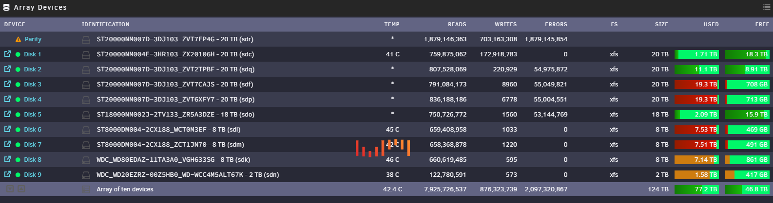

I have been trying to do parity sync for a week now and every time I do one I get errors on my drives. When I run my docker containers or run mover. I have changed all my SATA cables to brand-new ones and still errors.image.thumb.png.1b5ad5e8eeab4d4a8b342c99106c7552.png

However it is enough to show that you are getting errors on multiple drives.   Since you say you have checked the cabling (I assume this is the SATA cabling?) are you sure you do not have a power related issue?   Failing that what else is common to multiple drives?
Those are not the diagnostics, just the syslog, based on that looks like a controller issue, full diags may give a better idea.

All but one of the affected disks are using a controller with a SATA port multiplier, that can be a problem, and it usually is, but one of the disks is using a different controller, so could also be power related.
