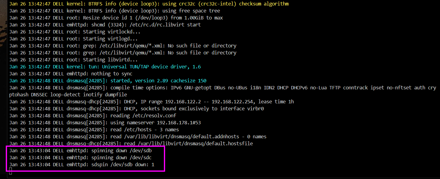

same problem with USB HDD (WD Elements 1 TB) here. I'm currently running Plex on a RP4 under OMV6 and think about upgrading. I bought a used Dell Wyse 5070 where i can use external HDDs only. The WD Elements spins down perfectly if connected to the RP4, and it looks like this also works on Unraid 6.12.6, but only a single time. The system log tells me that the disk is spun down, but in the next line i get:
emhttpd: spinning down /dev/sdb
emhttpd: spinning down /dev/sdc
emhttpd: sdspin /dev/sdc down: 1
Thats very similar to what was posted here:
Same error message. Looks like error code 1 for me. As a result, the disk is spun down correctly despite to this msg and spins up when accessed the next time. But then it will never spin down again till the system is restarted.

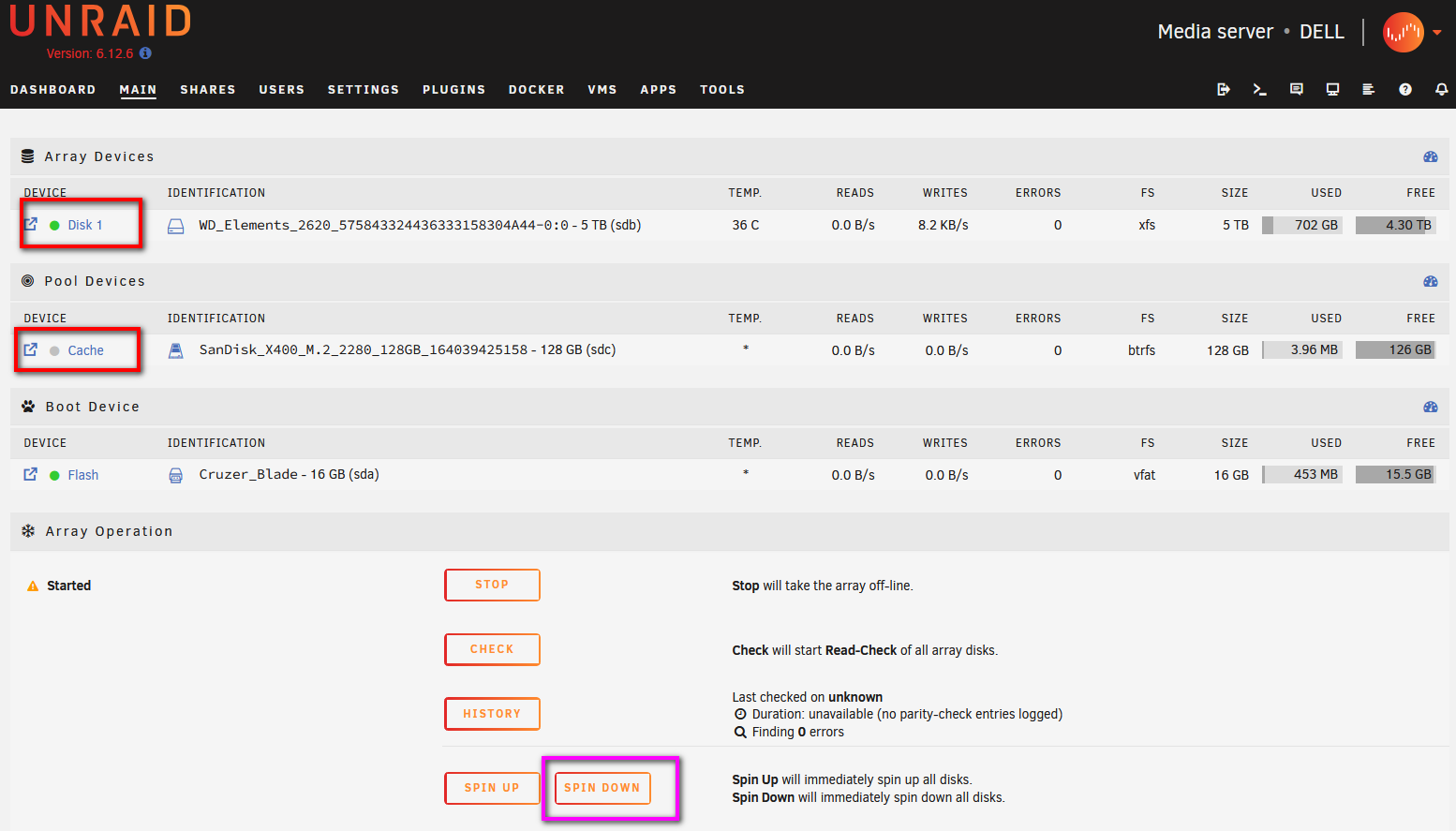

Hi there,
I'm exactly in the same situation my WD Elements 5TB runs all the time. The spin down all disks Button works for the internal M.2 SSD and the WD disk spinns down and after 2 seconds it restarts again.
If the Array is started in Maintenance Mode, the Spin Down also works for the WD elements drive.

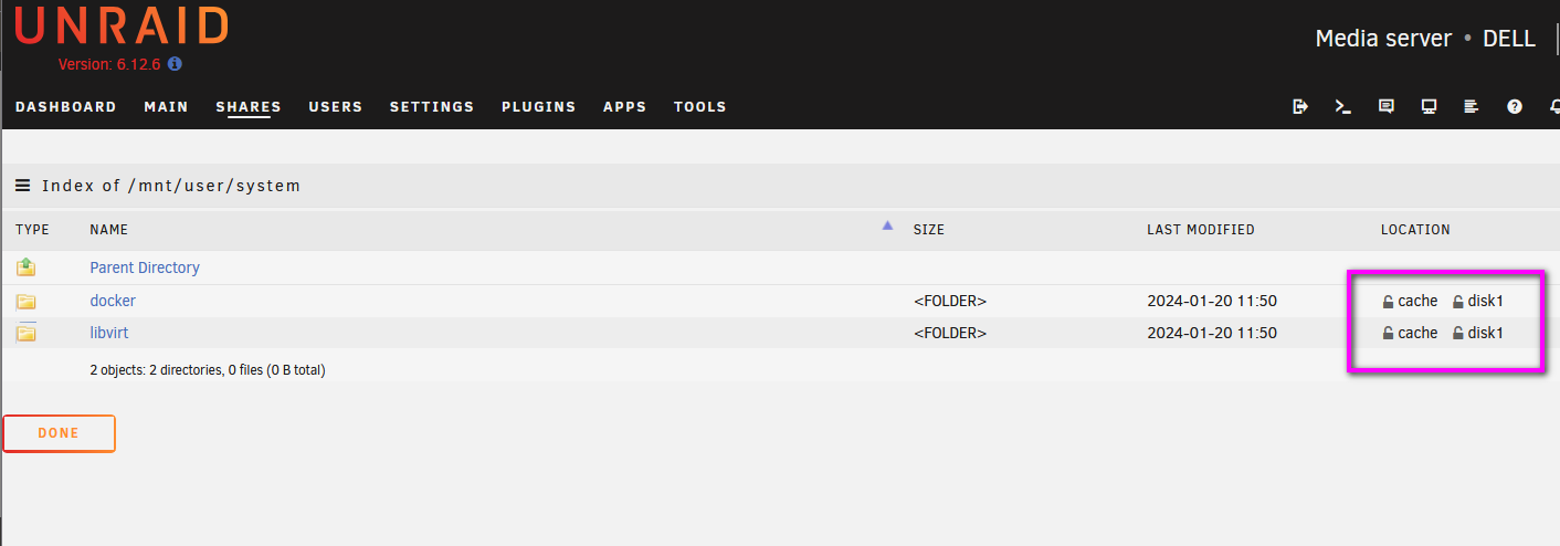

6 minutes ago, deBabba said:
no Docker or VM installed
But Docker and VM Manager are both enabled, and system share has files on disk1
Puh, this explaines why there is an access to the disk, but the System says:
  • No Docker containers installed
  • No Virtual Machines installed
The disc was formerly used in a test setup and maybe there is kind of garbage left 🤔
Is there a way to clean that up?
Thank you so much
If you have Docker and/or VM Manager enabled in Settings, then docker.img and/or libvirt.img are open files. These open files are both configured for the system User Share, which has files on disk1. You should move all system share files off the array.
Mover ignores shares that have nothing set for Secondary since those shares have no setting for Mover action.
Also, nothing can move open files, so you have to disable Docker and VM Manager in Settings.

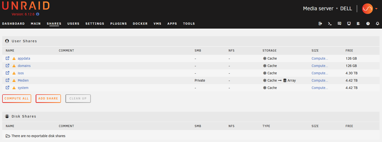

the disk went to sleep for 3 sec and restarted again.
The weired thing is that even all system shares are assigned to the Cache, they also appear on disk 1
Since I have no idea how to remove those directories from disk1 and maybe solve the problem, would a clean new setup including formatting the Disc and SSD be the best solution ?

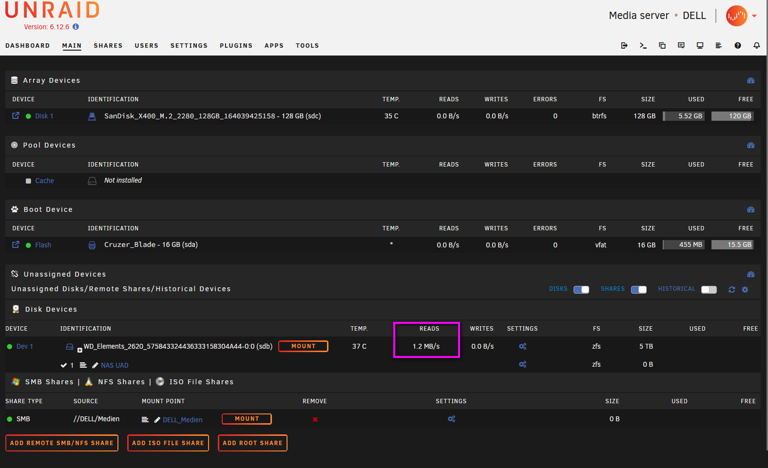

I was far to optimistic 😢
After a short time the disk behaves as before, so I followed the recommendation to use it in an UAD setup. This makes it even worse, there is a periodic read access to the disk and it it continoues spinning even when the System is shut down !!
So this disc seems to be a garbage for an unraid use case.
