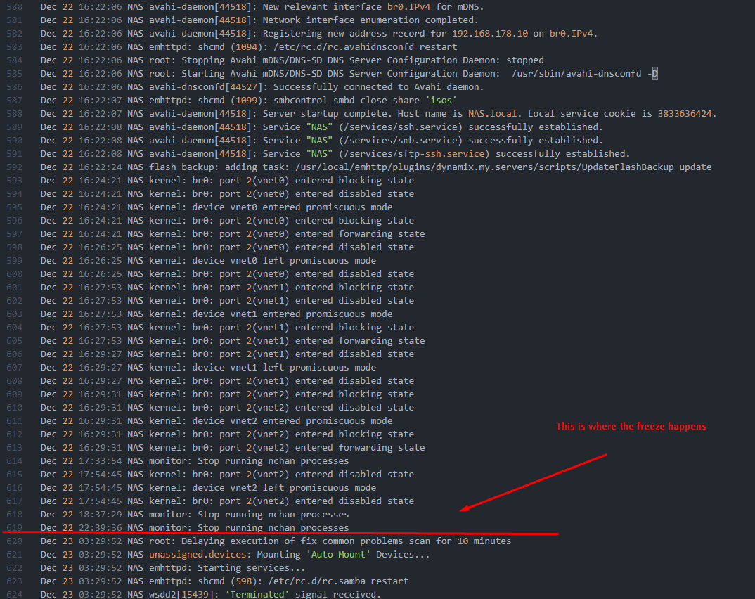

Syslog

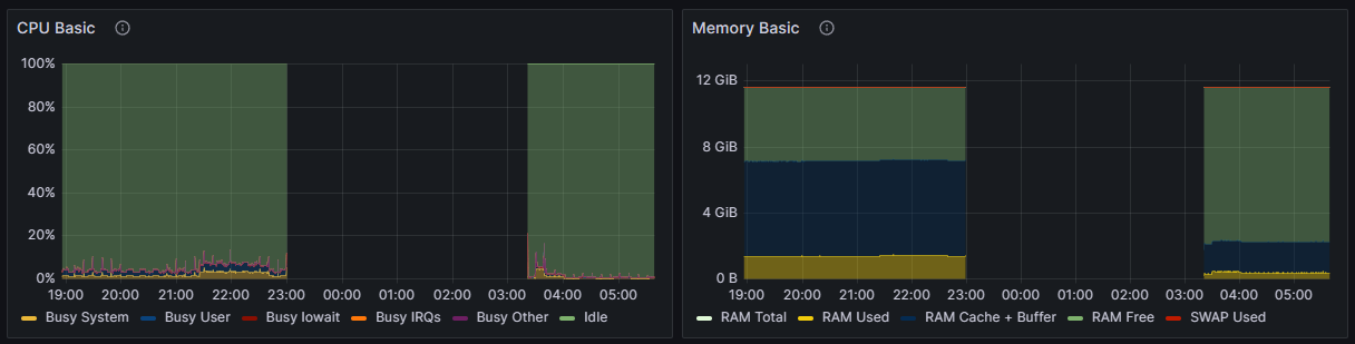

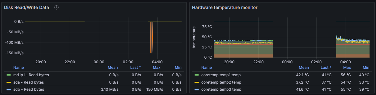

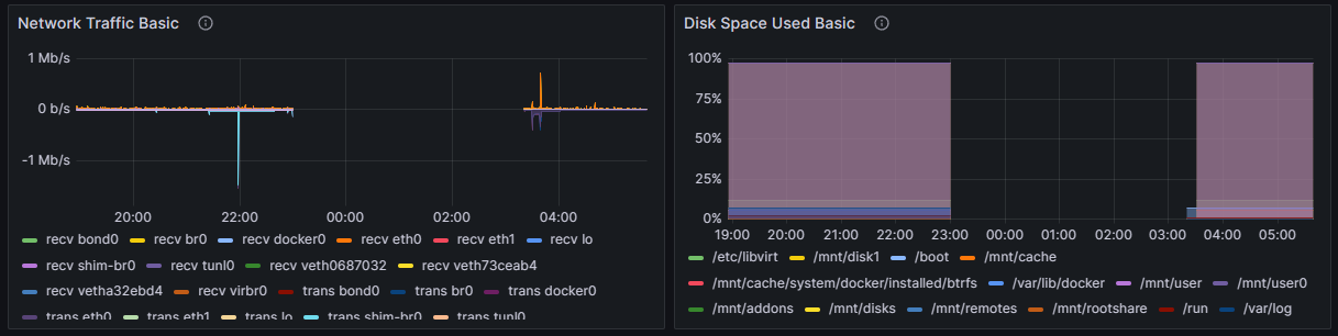

Monitoring

The last freeze happened at exactly 23:00:00 (Or 11:00pm). At least that's where the monitoring stopped. That means, that the last logs in the syslog file do not necessarily correlate with the freeze. I restarted the NAS manually at around 03:30am. All the parity checks I have been doing after the last freezes show me 0 errors. As far as I can tell, there is no planned task configured for 11pm on my server, and currently I do not know yet if the problem always happens at exactly 11:00pm, but as I have monitoring now, I will try to find out.

Unfortunately there's nothing relevant logged, this usually points to a hardware issue, one thing you can try is to boot the server in safe mode with all docker/VMs disabled, let it run as a basic NAS for a few days, if it still crashes it's likely a hardware problem, if it doesn't start turning on the other services one by one.
