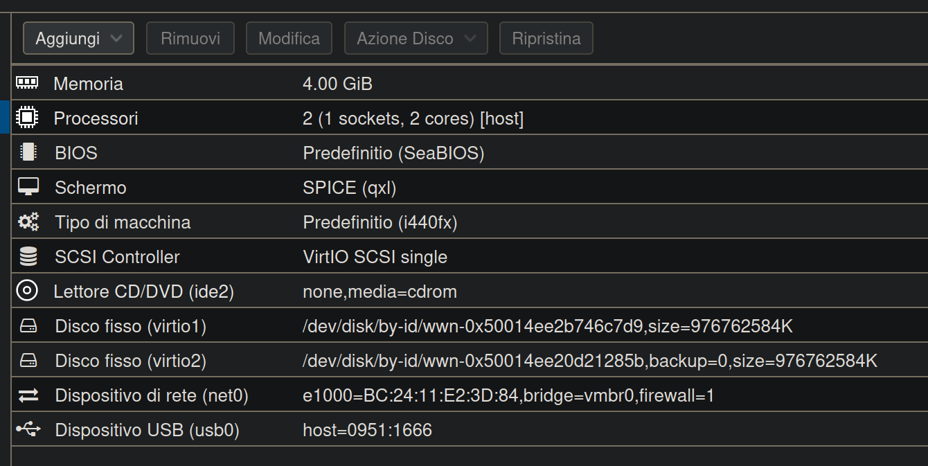

I m very new to unraid, just installed with proxmox
As first I followed this guide

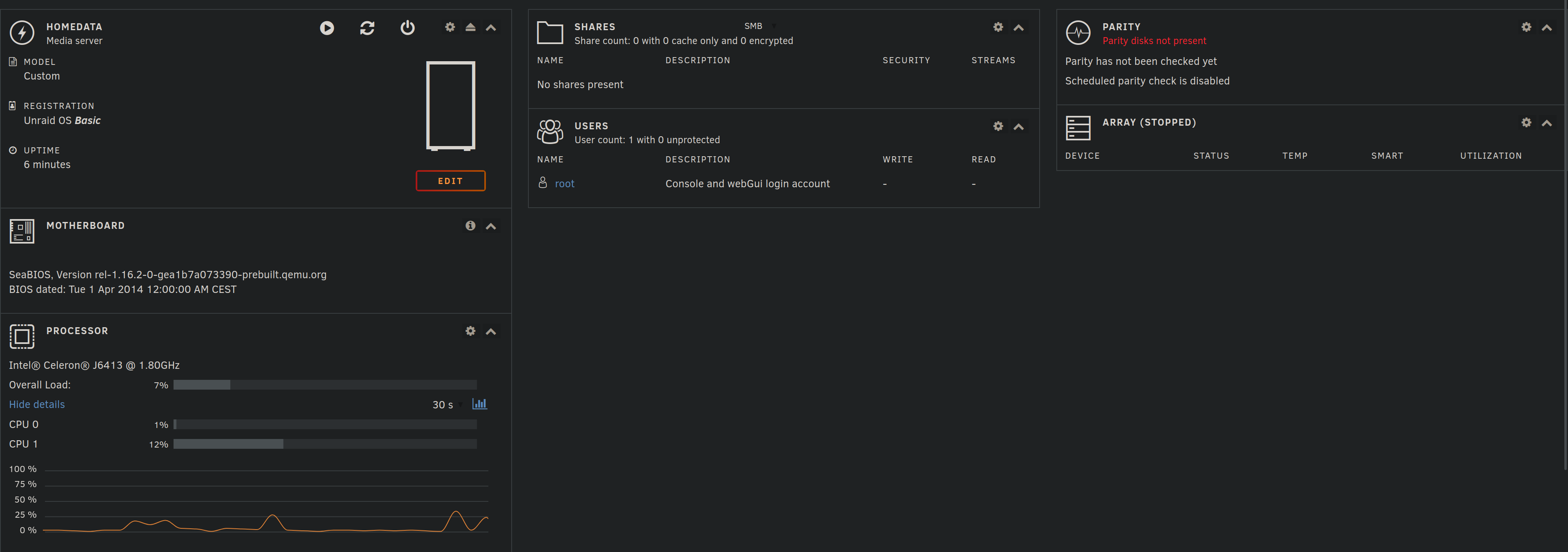

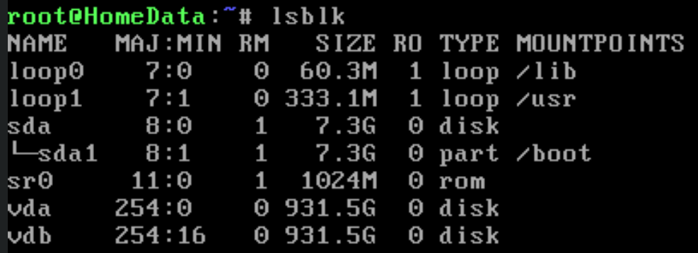

with lsblk i correctly see the 2x1TB drives I passed through, I tought the issue was unraid in trial version (i already had the key but did not redeem yet) even after redeem the array is still showing empty
Now to be honest i do not know if this is the expected behavior (lets say as when you do not format the drive in windows), so i tried formatting vda in ext4 along with a mount point in /media/disk but still nothing
I really have ho idea on how to proceed and I would really thank you all for an hand on this :)

Dec 24 18:32:51 HomeData emhttpd: device /dev/vdb problem getting id
Dec 24 18:32:51 HomeData emhttpd: device /dev/vda problem getting id
This usually means both devices have the same ID/serial, also it would be much better if you can pass-through a controller to Unraid, instead of using virtual disks.
