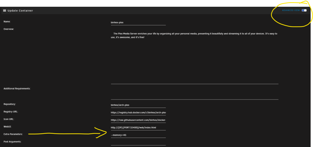

How do you limit Plex's RAM usage? It just crashed again last night. i feel i can safely say it's Plex causing unraid to crash, but now i want to troubleshoot and fix my plex install while i will be remotely away instead of having my server constantly crash. I also pinned the Plex container to only use CPU 4-7 / HT 12-15
Edited by Linguafoeda

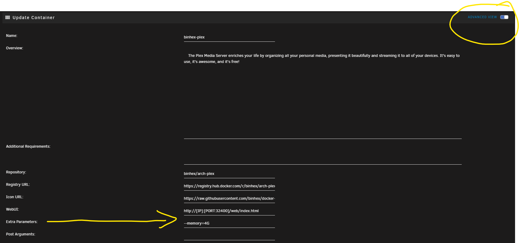

In the container's settings, toggle advanced view and add this into the extra parameters field (whatever amount of RAM you want to limit to, I just use 4G
--memory=4G
as an update - a Plex employee told me this is a known bug with the BETA plex version 1.40.7775 which i had been inadvertently on. I changed the VERSION variable of linuxserver container from "latest" to "docker" and it downgraded me to 1.32.8.7639. the problem has disappeared. Hallelujah
