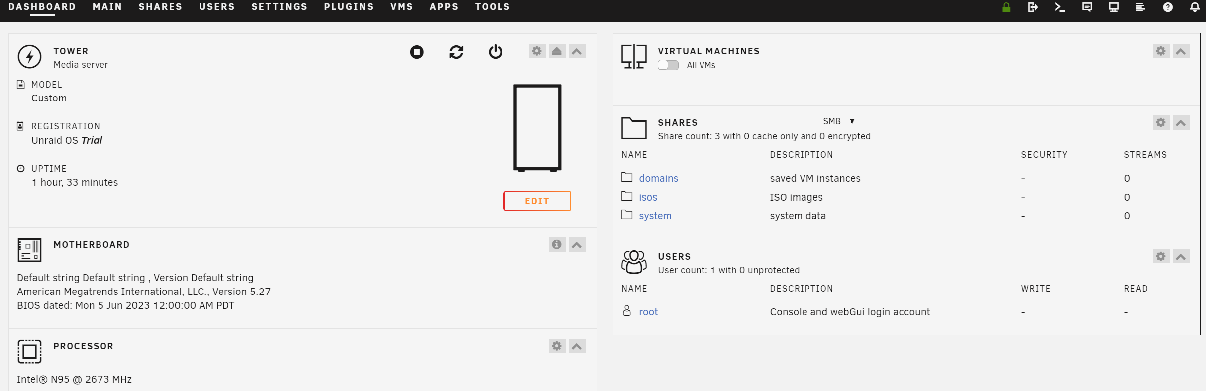

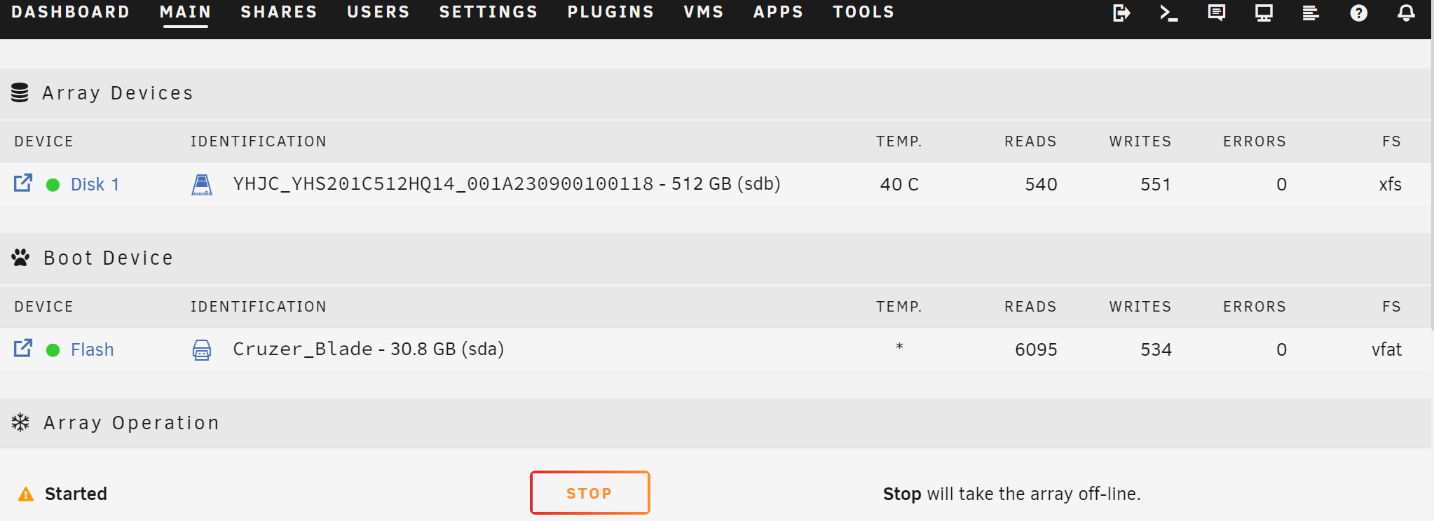

Upon switching to the "Apps" section, I encountered the error message "Docker service not enabled." I've searched the Docker FAQ without finding a solution:
The "Dashboard" and "Main" sections appear as follows.

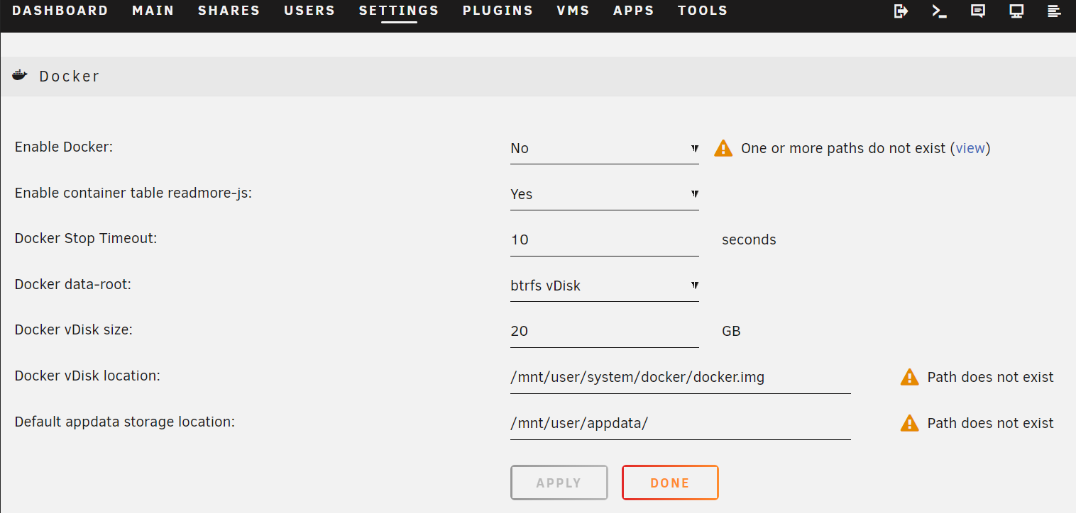

Solved by Squid
14 minutes ago, ral9004 said:
Could you please guide me on how to proceed to enable Docker?
Settings / Docker Settings / dropdown menu

2 hours ago, ral9004 said:
I install Unraid and one of the Basic Feature like Docker don't work?
Usually best to not enable Docker until other things are setup, so it is not enabled by default. For example, if you have no formatted drives to work with yet, there is no place for Docker to live.
And it is better if Docker and VM related things live on fast storage like cache or other SSD pool. If you enable Docker before you have a fast pool for Docker to live on, you have to do some work to get it moved off the array.
