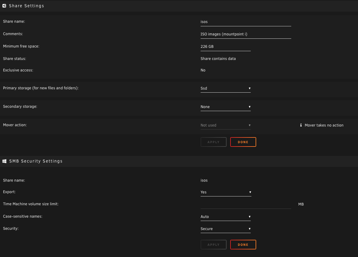

My share configuration:
783065874_Screenshot2023-12-25at15_51_10.thumb.png.2d7d5ac9e4d7fbc46a1b962af2289d82.png

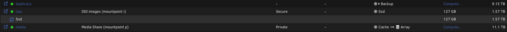

A compute in the share overview, showing the exclusive on another share and that there is no other data on another drive
1847412050_Screenshot2023-12-25at20_32_30.thumb.png.a3fe387d2097ac10d9ab1a46a7df2bd8.png
