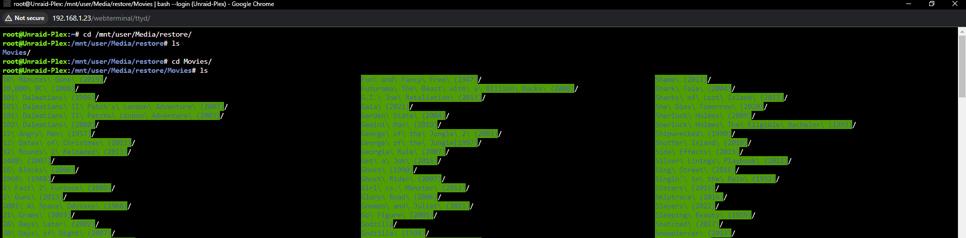

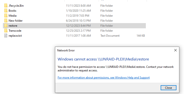

i recently had a drive fail and wasnt able to get it to come back properly i have since formatted a drive and tried restoring some of the data by copying it off of copy of the failed drive the data is there but im getting permission issues when i try to access it. i have Run the Fix common problems plugin but havent got anywhere. i do see some BTRFS errors in log file but im not the best with linux hoping to get some help
image.png.b78c4b9baf1b16455e64664d5471da0d.pngimage.thumb.png.35c038243eb7c3eef449f35f9c75f4a0.png
