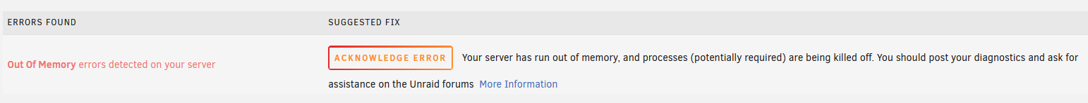

I just got my unraid plex server running, but it periodically seizes up. When I clicked the fix common problems link in the Settings, the memory error was indicated, as shown in the screen shot image. I have also attached the diagnostic information as suggested.
If you guys can help, I sure would appreciate it.

Enable the syslog server and post that after a crash.
For the OOM, if it's a one time thing you can ignore, if it keeps happening try limiting more the RAM for VMs and/or docker containers, the problem is usually not just about not enough RAM but more about fragmented RAM, alternatively a small swap file on disk might help, you can use the swapfile plugin:
https://forums.unraid.net/topic/109342-plugin-swapfile-for-691/

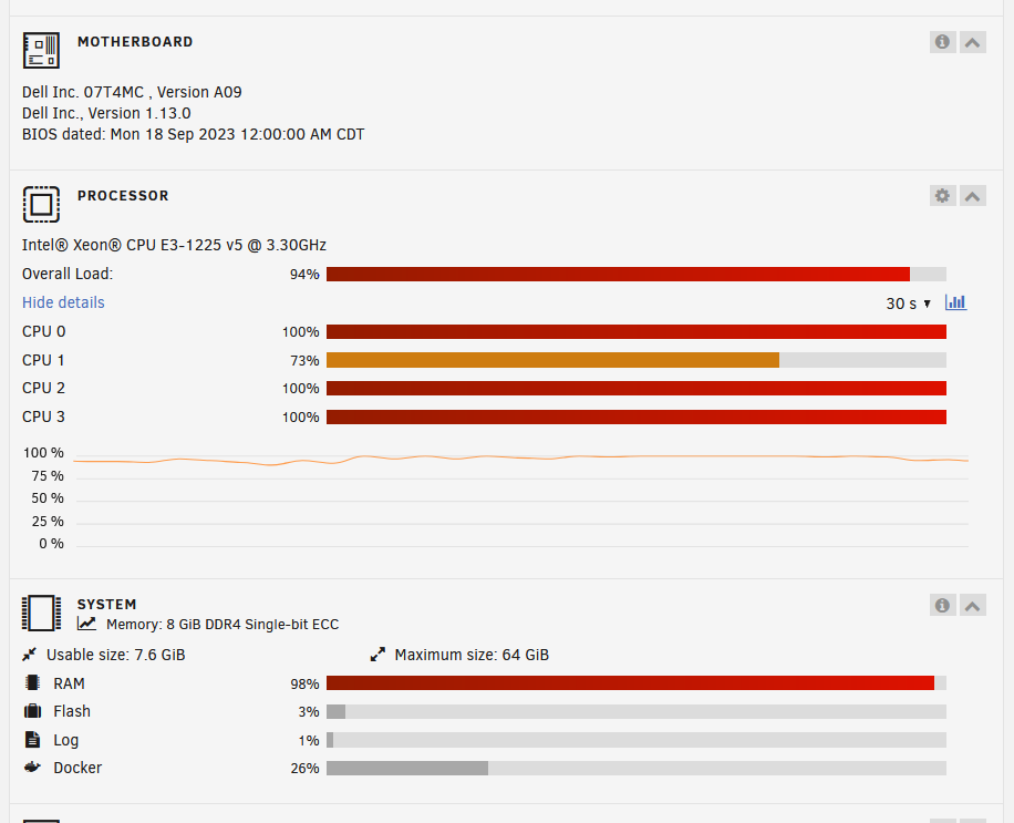

I think I am getting ready to go down again. Here is a screenshot of relevant sections of my dashboard page:
Post current diags.
I believe it's docker related, but cannot see which one, you can try turning all containers off and then enable one by one and let it run the time necessary to confirm that one is not the problem, before enabling the next one.
You are a genius. That appears to have done it. Thanks.
