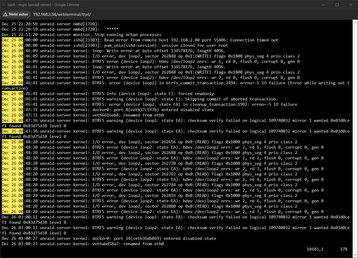

Found this in the logs as well. Do you have any idea why I am having so much corruption issues lately?
That is the corrupt docker image, though if it keeps happening it can be a symptom of another issue.
