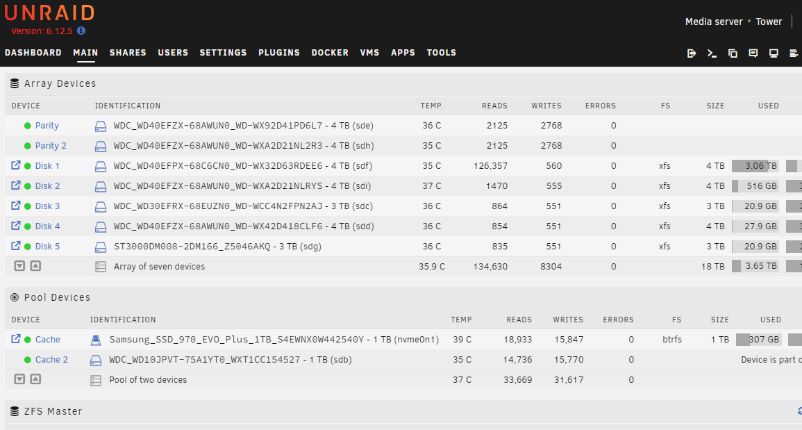

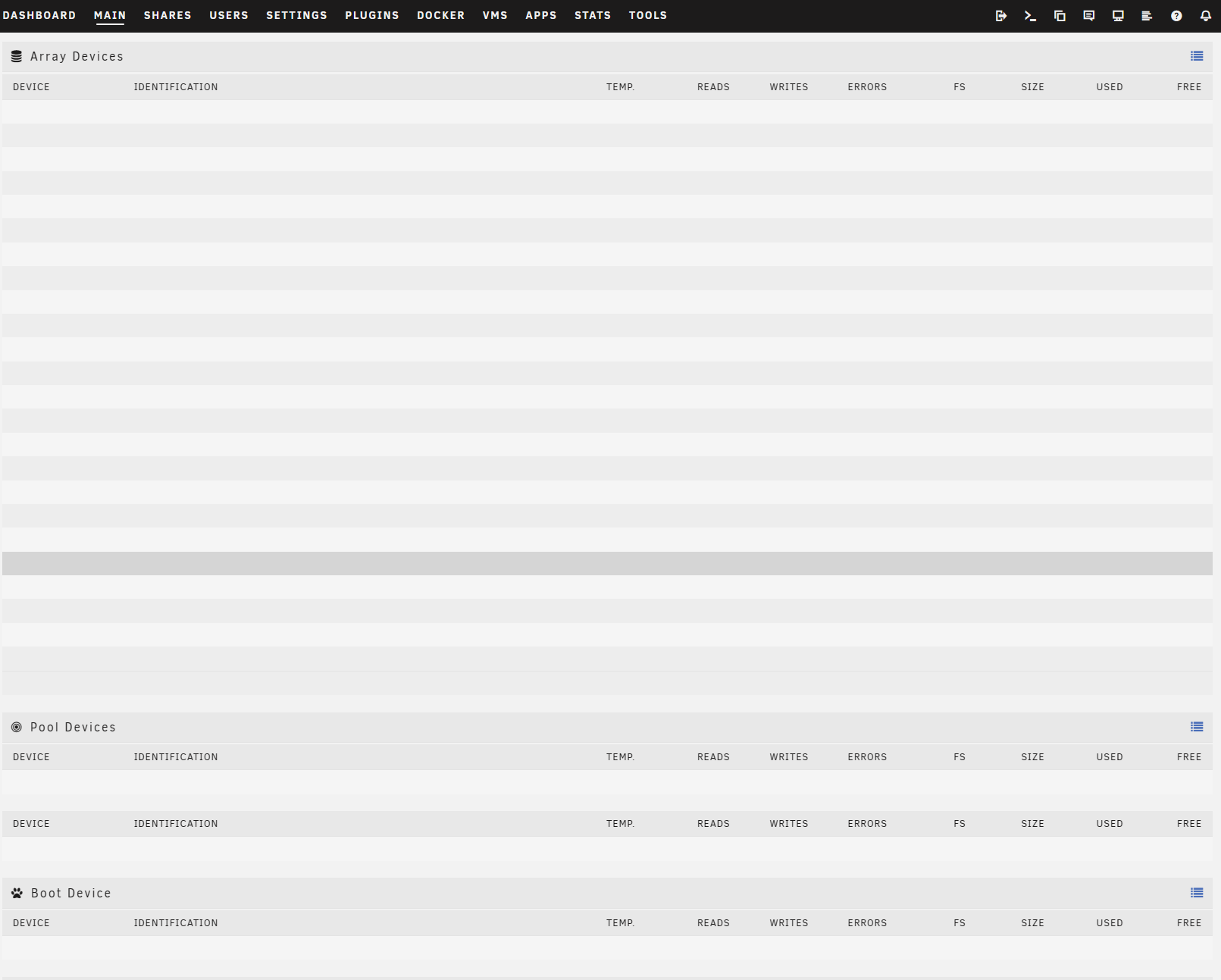

The issue is that when I log into my Unraid GUI through my domain, my array devices (under Main) do not show as shown below.
However, when I log into my Unraid GUI through my Lan IP addresses, it shows the arrays devices like normal as shown below.  This is what I intended to see with the domain setup.

In Nginx Proxy Manager, edit the Unraid proxy and enable Websockets support.

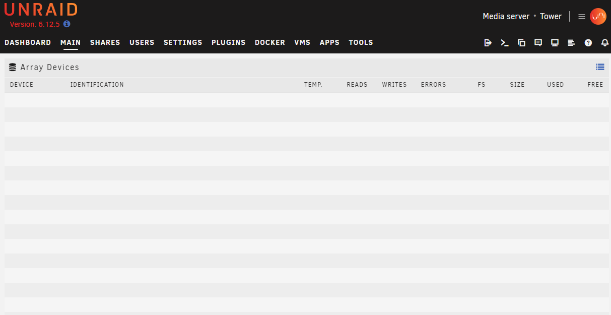

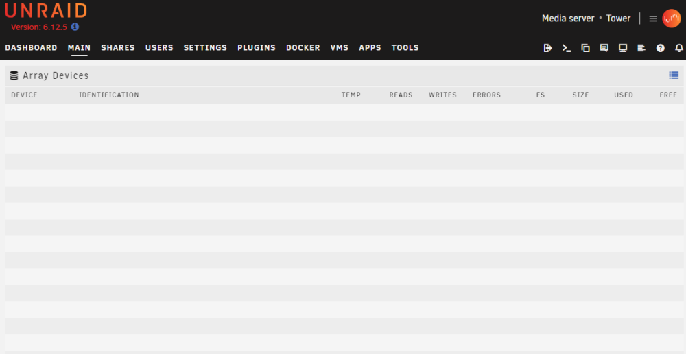

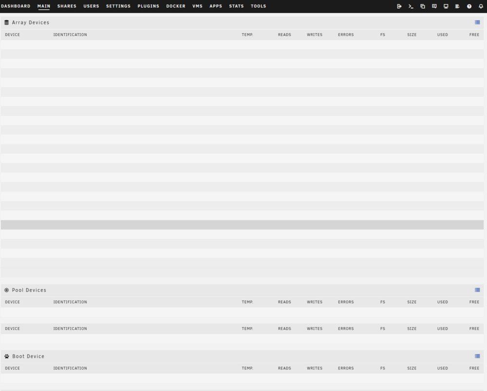

I have the same problem (6.12.6), no array devices showing in the Main tab of the GUI. This happens regardless of how I access the GUI. I've used my usual http://tower/Main as well as the IP address and it happens regardless of browser. Same problem if I try to access from my Android phone. Other tabs and the rest of the GUI seem fine.
I've tried stopping and starting the array (NOT rebooting), but that doesn't work.
tower-diagnostics-20240603-2025.zip
OK, followed the link provided and am pleased to say it solved the problem. Thanks.
