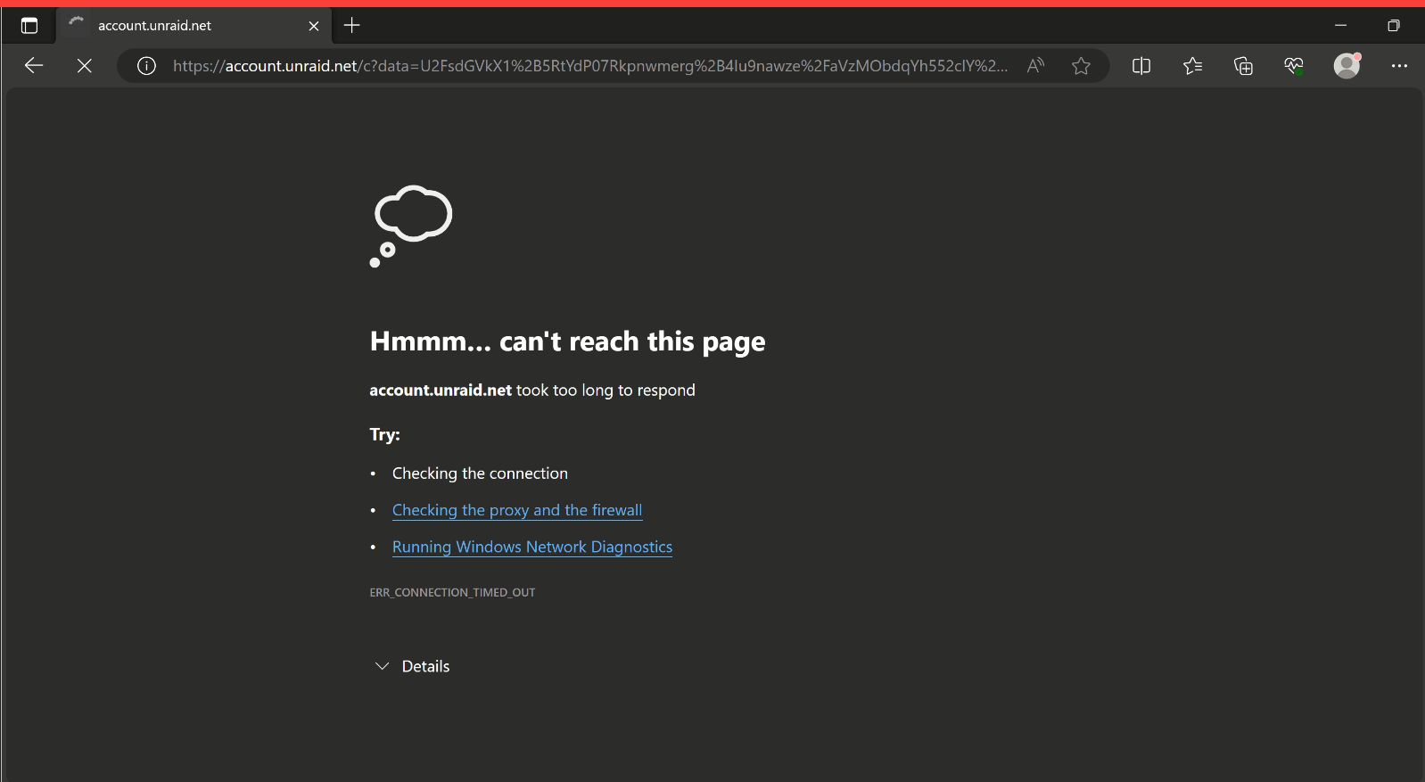

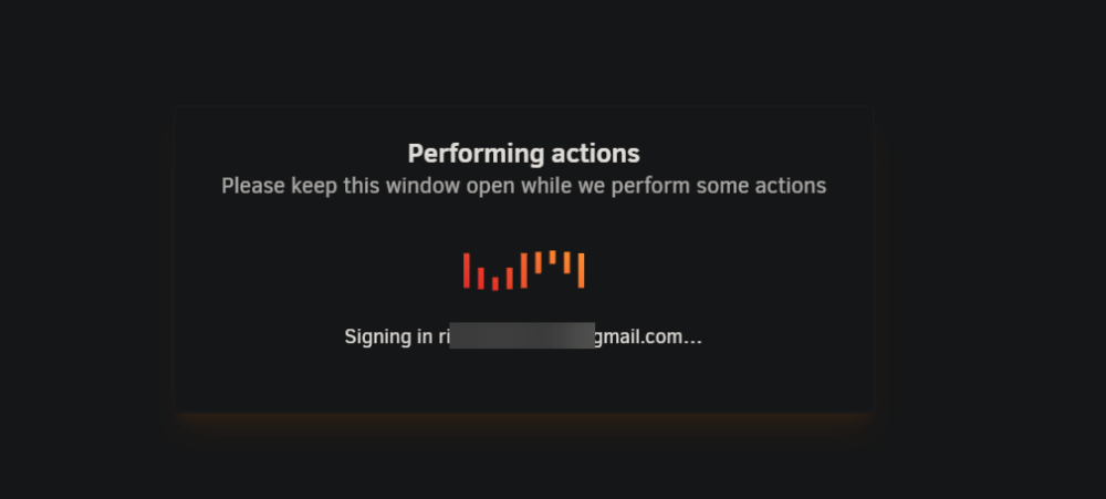

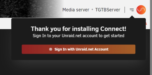

I cannot connect server to unraid.net
Currently my sever is unusable.
This is the second or third time it randommly disconnect from unraid connect

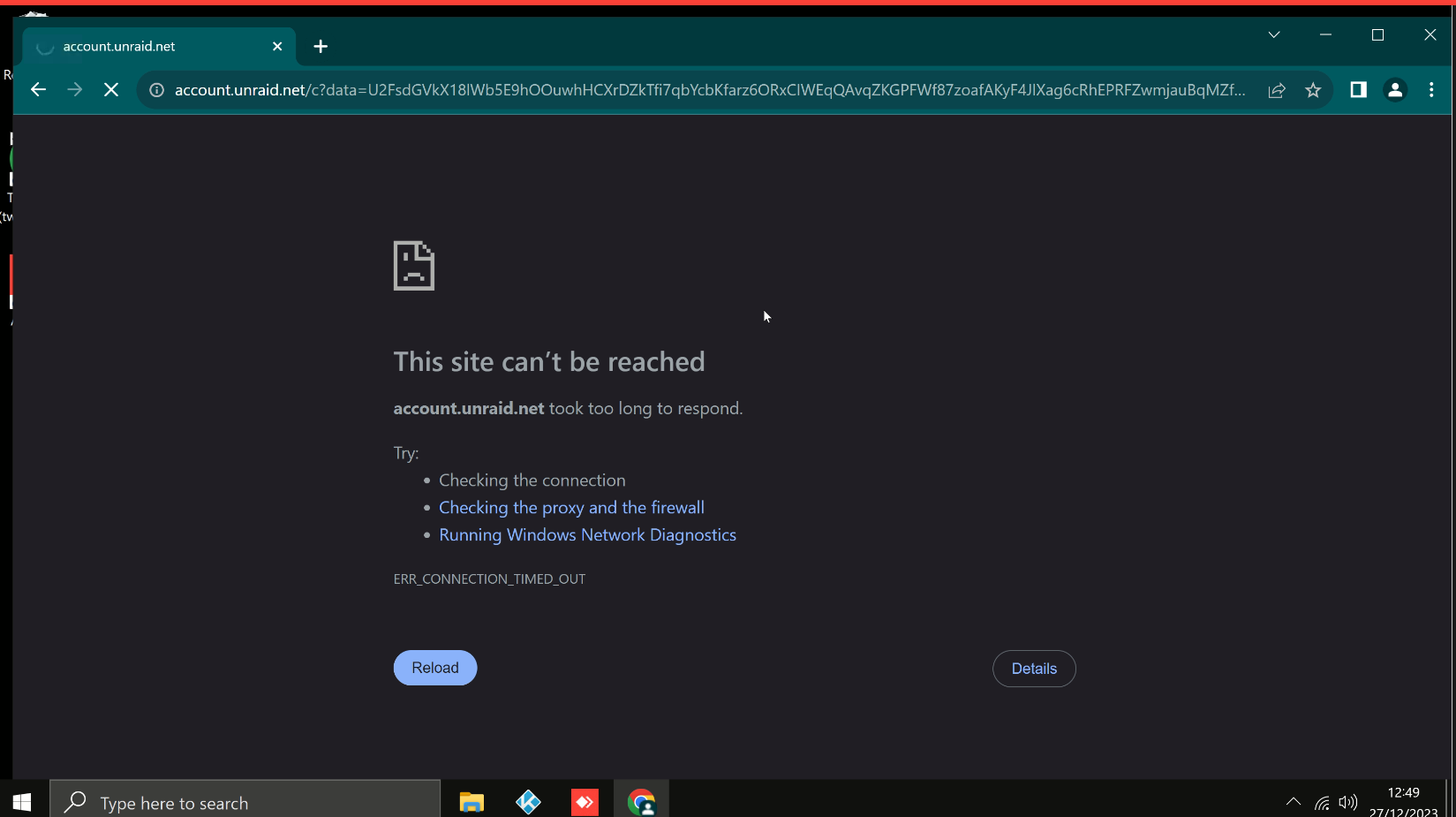

when trying to sign in, the page does not load. im doing this directly from my IP
I tired differnt browsers, incognito window, still fails to load page
attached: diagnostics and api logs
i got through via cloudflare to this screen , but it just hangs here: so far 60+ minutes still loading

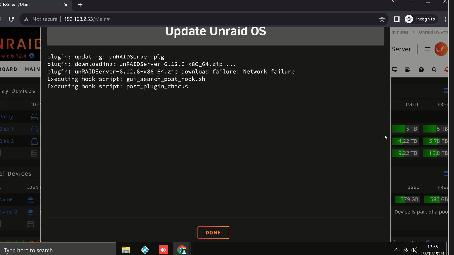

obviously I cannot update either:

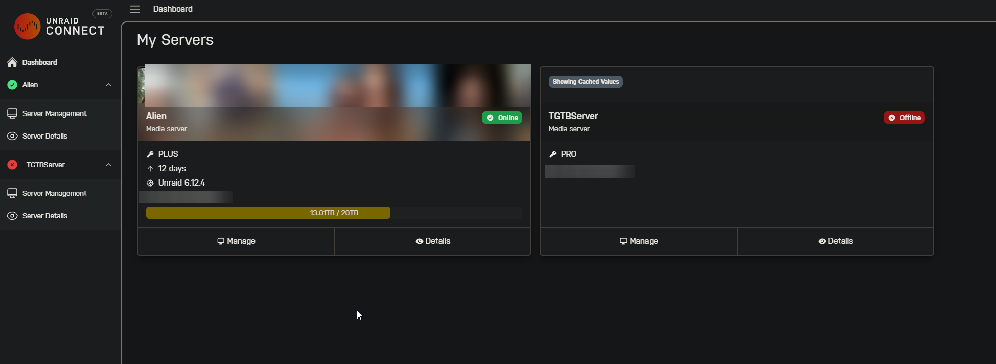

on myunraid.net one server if fine while the other is broken

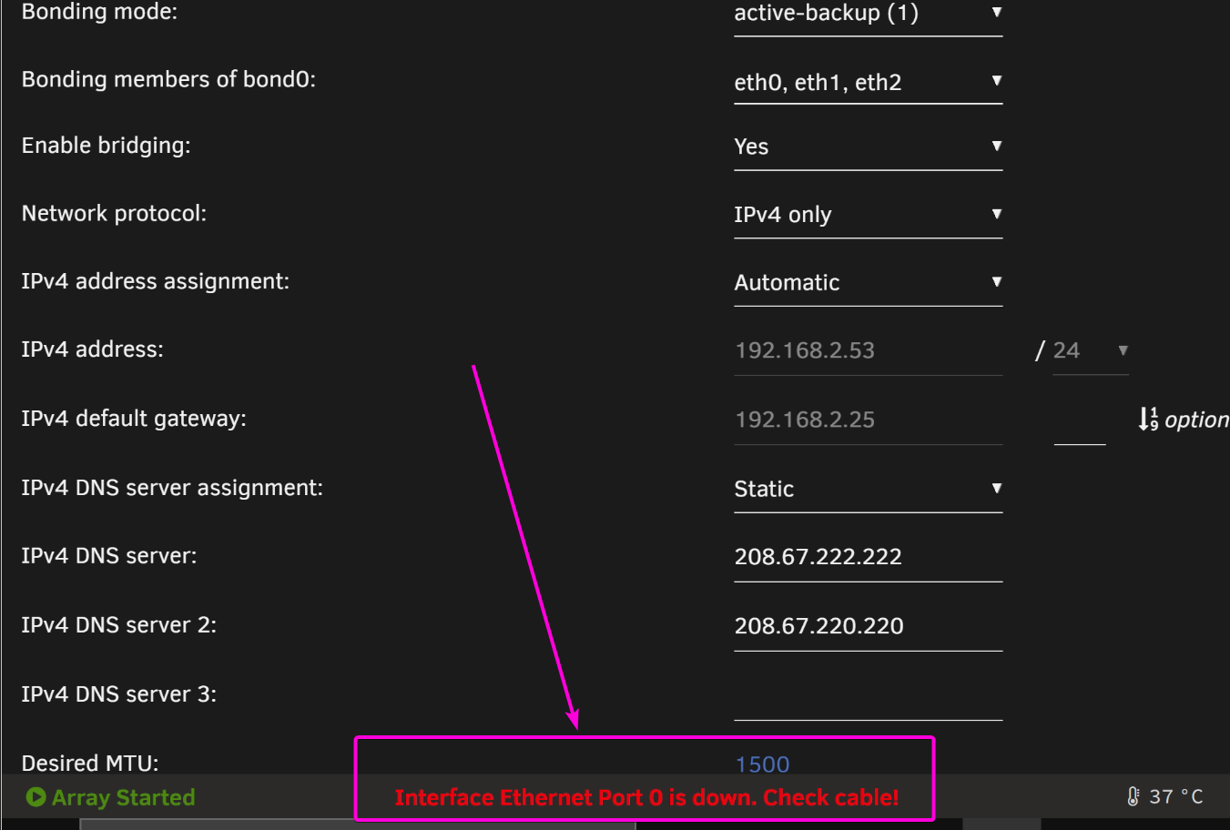

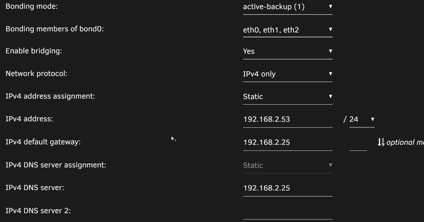

IPADDR[0]="192.168.2.53"
NETMASK[0]="255.XXX.XXX.0"
GATEWAY[0]="192.168.2.53"
METRIC[0]="1"
DNS_SERVER1="192.168.2.53"
You are using the server IP as the gateway/DNS server, use your router IP as both.
Iv since reset the network settings. And now the DNS is the router. But this was no help.

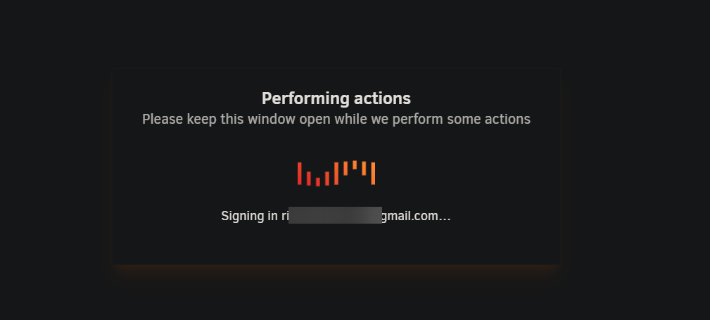

Please see updated diagnostics and 2 videos
1 from local IP, 1 via cloudflare domain
its interesting i get further with cloudflare

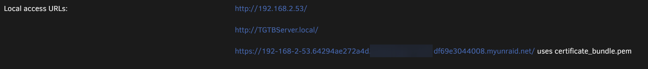

I have tried all ways to access the GUI to attempt differnt results
http://tgtbserver.local/Main
IP
and the one with certificate

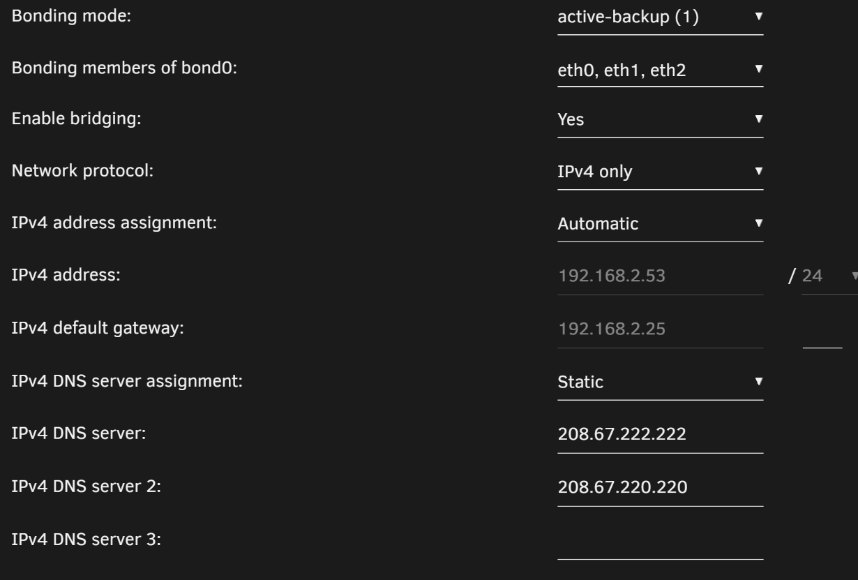

Try using DHCP instead and/or try changing your DNS server to 208.67.222.222 and 208.67.220.220 instead of using your router.
no change...

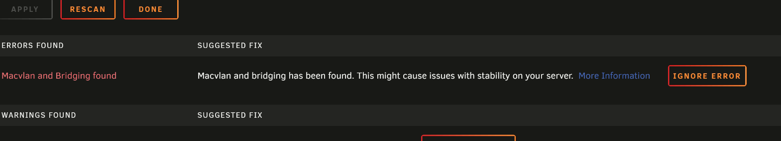

I do have this one error here, but that just because I have unused ports.. but i wonder if that is causing a problem somehow

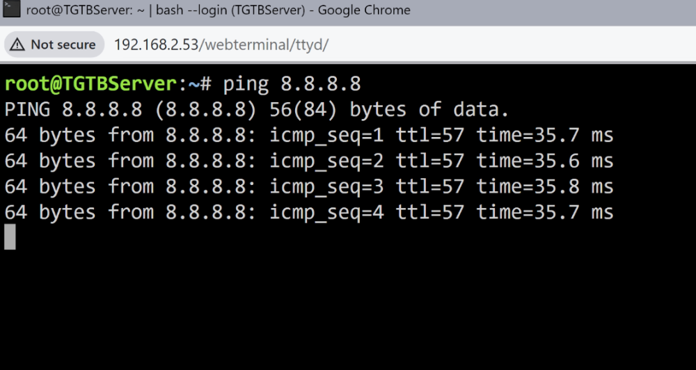

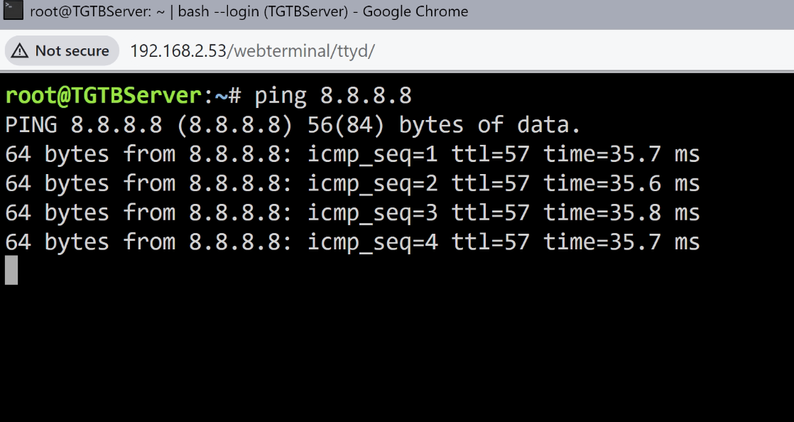

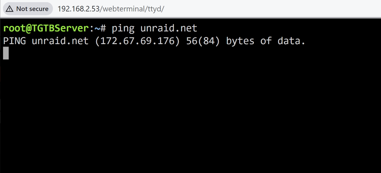

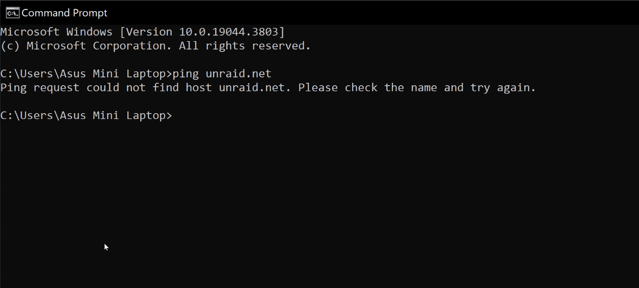

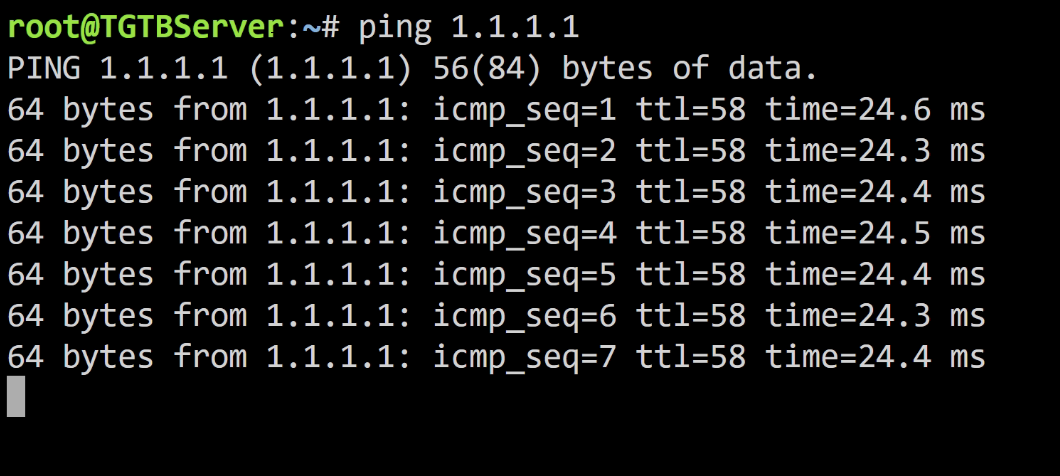

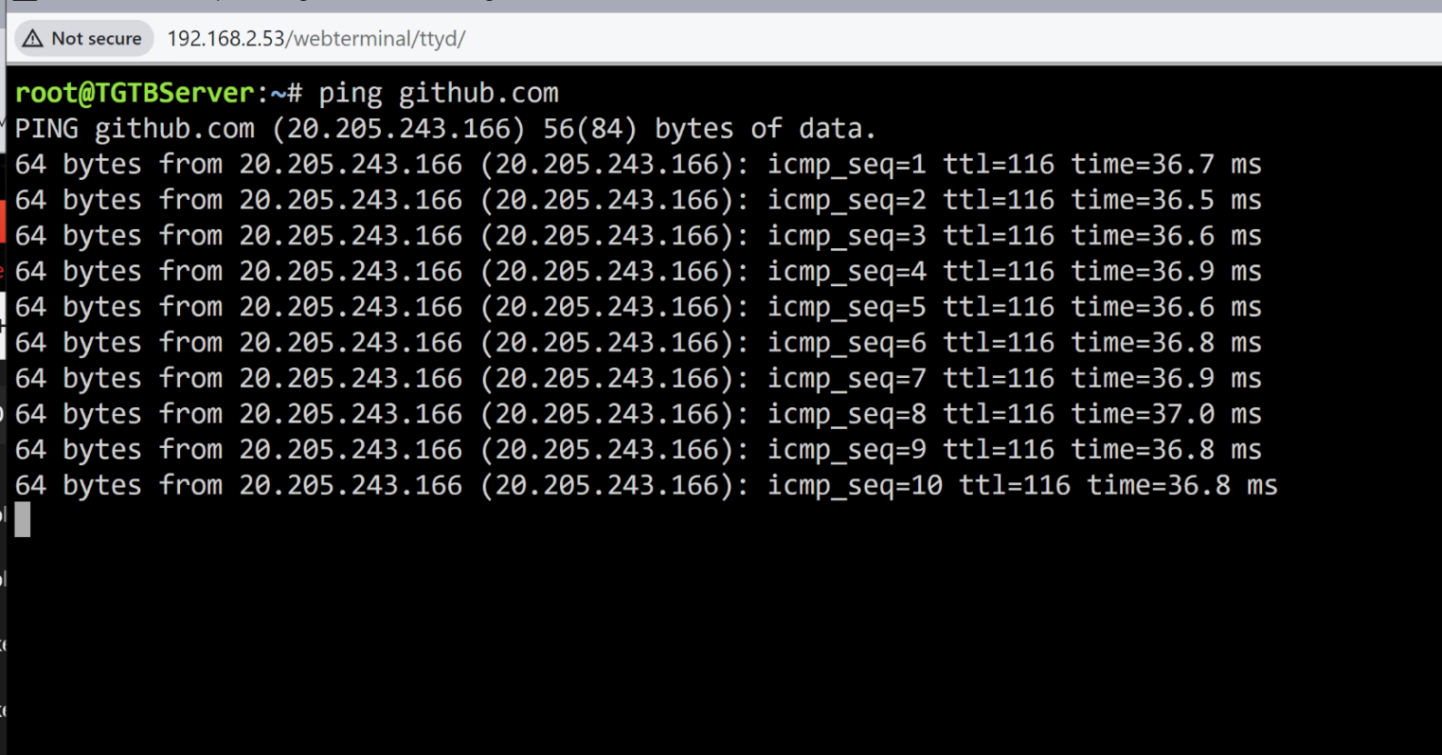

pings
Windows terminal
Sorry but not clear to me, can the server now access the internet? Is the problem just with Connect?
