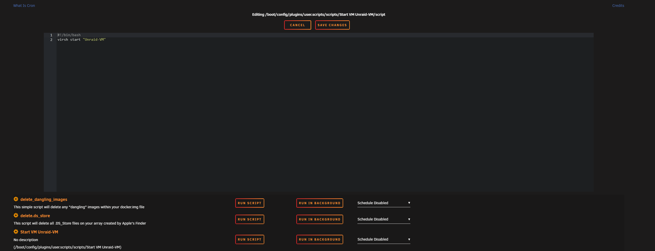

Would be Bash in unraid. Here is a link to a script.

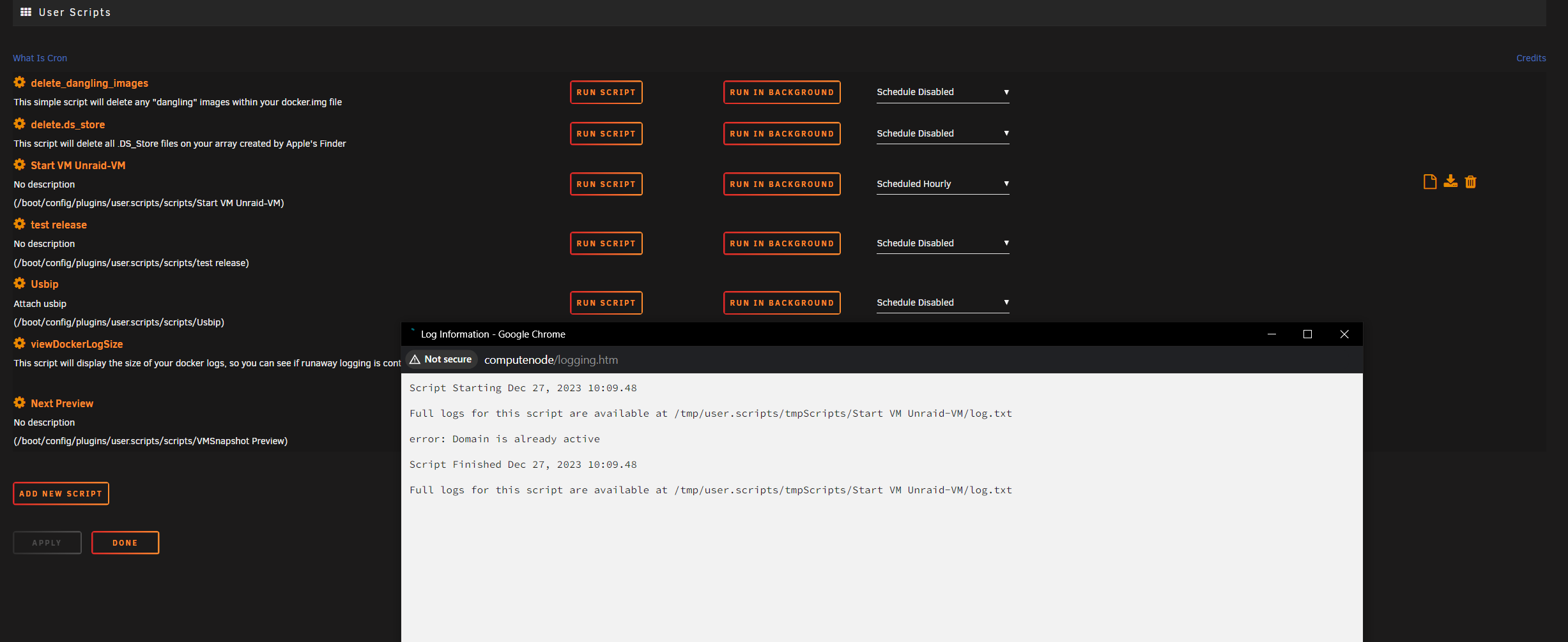

But  you could just add into user scripts plugin(Install from CA) to run the command virsh start VMNAME every hour, you you can create a custom schedule using cron format. Note you will get an error in the log if running with the simple solution.
Then set the schedule:
It is working 🙂
Thank you very much and a happy new year.
