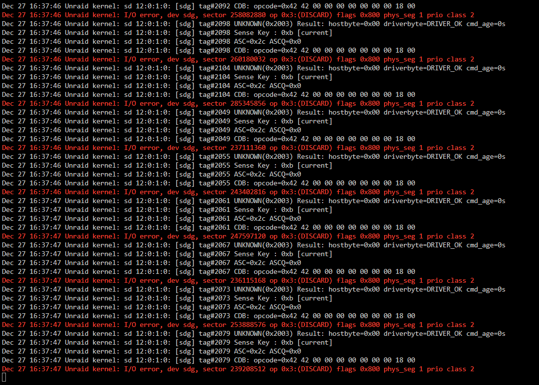

Hi all,
Recently I replaced my mirrored cache drives with 2 SSD enclosures in which I have 2 NVME drives in each, set up in SPAN.
Since I replaced them, I am getting the I/O error in the syslog.
Unfortunately I can't download the diagnostics, as it stays like that forever... Video here.

Are these using USB?
Log shows errors for sdg and sdj, are these the pool devices?
Enclosures are SATA. these.
And yes, those are the drives.
Edited by GaBoNtZ
The link is not working, so are the devices SATA, not NVMe?
SATA enclosures for NVME with RAID options.
Maybe this time the link works here.
There are 2 NVME devices in each, with RAID set to SPAN.
The cache pool is using both adaptors/drives, and are mirrored.
Edited by GaBoNtZ
According to the link it's for M.2 SATA, not NVMe, in any case I would recommend retesting without the enclosure, not sure it will be supported.

It works, but I just noticed those errors in the live syslog.
Edited by GaBoNtZ
Some of the errors may be from lack of TRIM support, still would recommend testing without the enclosure, Unraid should have direct access to all devices.

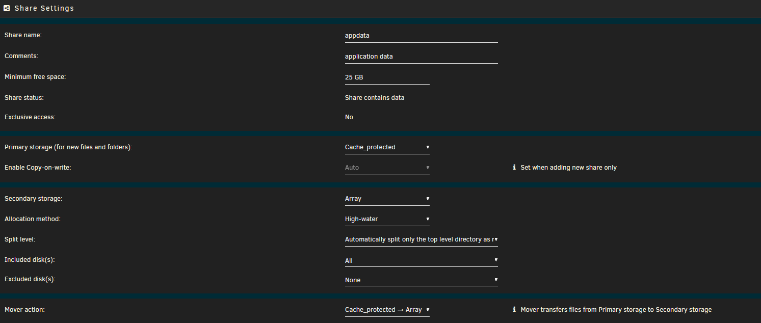

So mover will not move everything from that pool.
The pool is a cache pool for appdata, isos, system and domains and all of them were set like in the prhoto.
It doesn't seem to run anymore, because I can't see any new read/writes on any of the pools, but the move button on the main is greyed out, saying mover running.
It's been like this for many hour.
Anyway, question is: if it didn't move everything, can I move manually, format the drives and move them back?

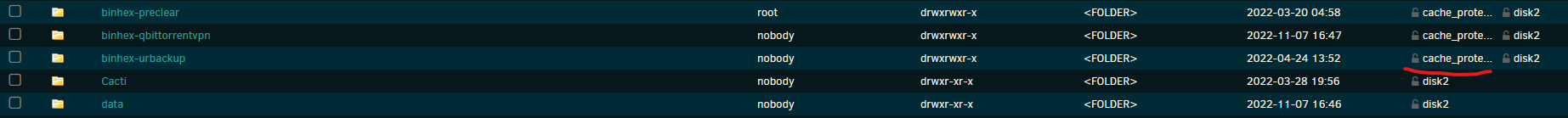

Also, I don't understand why some of the folders show up like this:
In my understanding, that means those folders are still on the cache drive.
Docker and VM are stopped and not running.

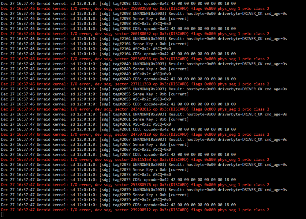

Try to get the syslog:
cp /var/log/syslog /boot/syslog.txt
syslog.2syslog
Edited by GaBoNtZ
Log is filled with ATA errors for sdj, try to manually copy what you can, mover probably not going to work.
That's what I'm trying to do now. TA
