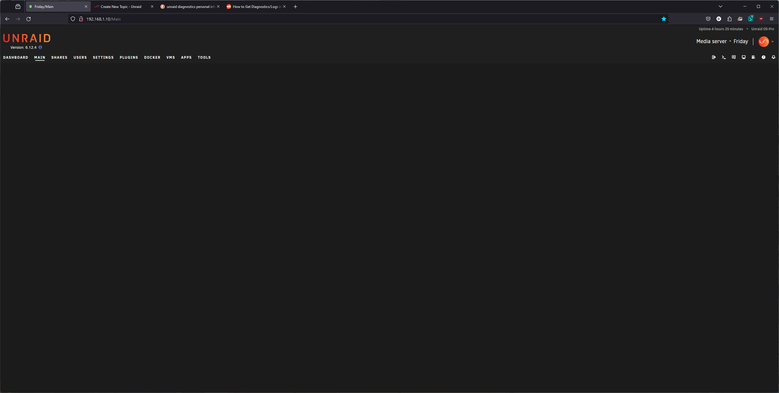

Web GUI not loading, server freezing up.
I've attached a screenshot of the issue, as well as my diagnostics.
(Please let me know if there was any sensitive information I should've redacted)
I've had a few unclean shutdowns lately as a result of my server completely locking up.
For months now I've been dealing with my Web GUI not fully loading, after a few hours it typically would come back up and I could access it without needing to make any changes.
It seemed random when it would occur, though as I've been doing some troubleshooting I've noticed messages in the syslog like this one.

The Web GUI does load though, it loads and will work just fine for several hours, and then it'll stop for a few hours, and then it comes back again.

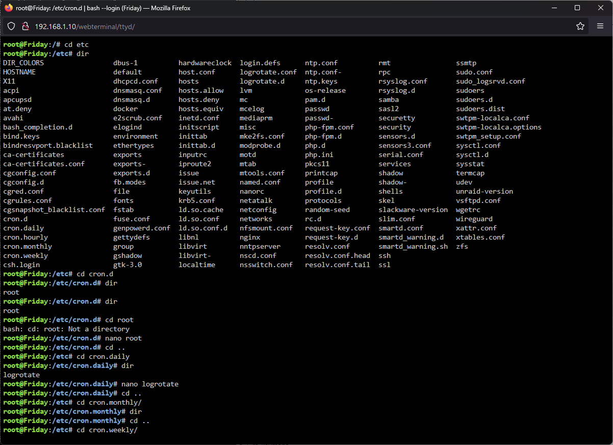

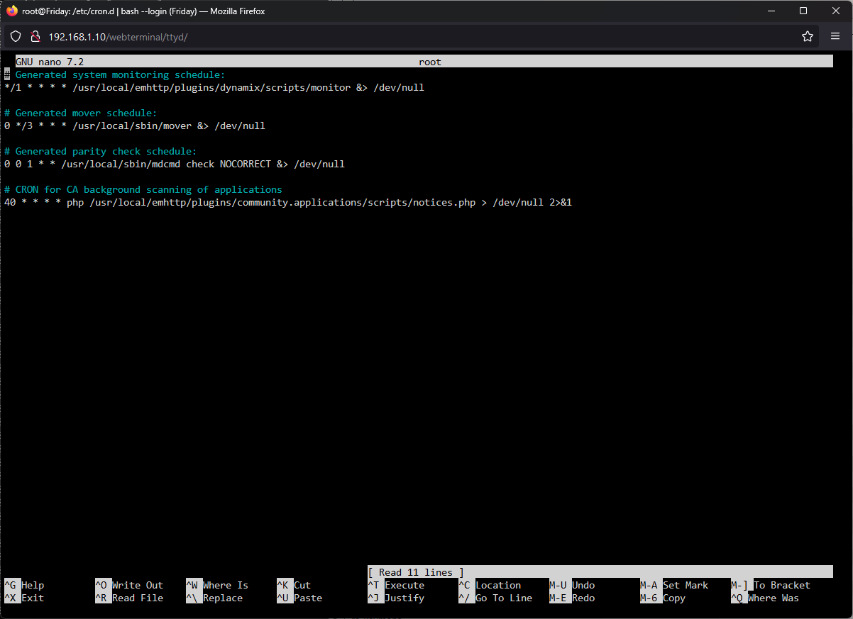

It might be worth checking there is nothing scheduled to run at around that time.    I would be looking through the various .cron files stored under /etc/rc.cron.
That directory does not appear to exist.
I did look through the cron.d directory and found one file named root, and have attached a screenshot of its contents.
