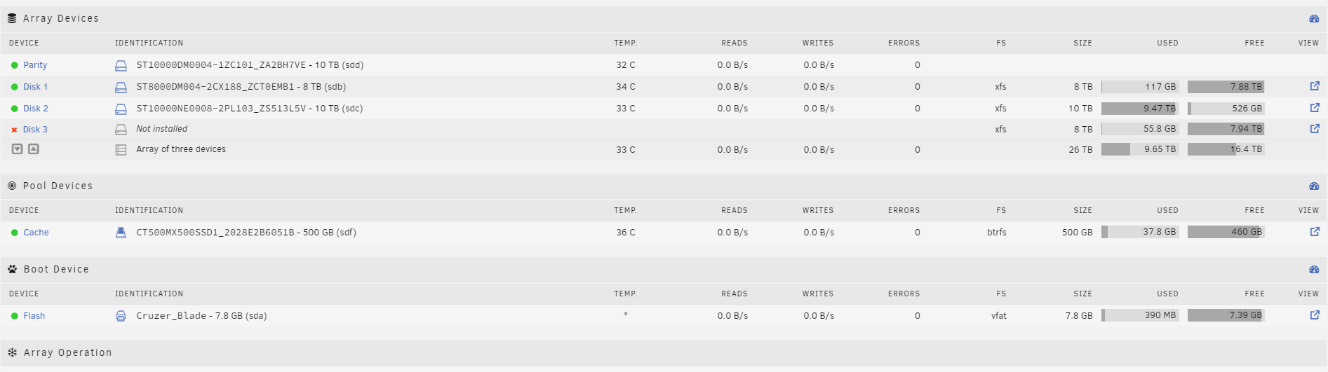

Device is missing (disabled), contents emulated; Trying to remove drive now
Hi Team! Basically randomly my Disk 3 has the above message. It's really strange, I haven't physically opened up my server but I atleast just wanted to remove it from the pool (the drive has been fine for months and the server has not physically moved). When I tried to run the server in maintenance mode, I do try and repair and such (assuming its not physically disconnected with a bad cable which maybe it is).
I am now trying to remove the drive, but I want to be sure the 'contents' have already made it to the other drives. Any suggestions on what I should do next? I saw a similiar thread but that was where the drive was still somewhat behaving as connected.

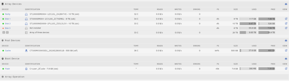

Added new photo
Disk appears to be empty, if you have already copied the data, you can do a new config and re-sync parity without disk3.
Thanks JorgeB. How do I know if the contents are actually copied (asking because of the message that says ‘contents are emulated).
Once I confirm that I’ll look up setting up new config and making sure I don’t break anything :)
Look at where you copied them and check they are there.
